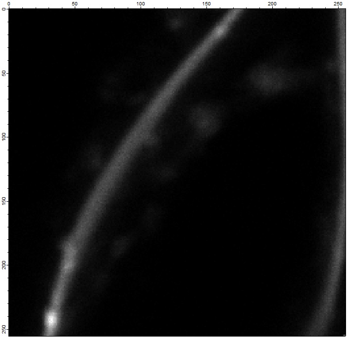

I build an average image of the intensity (256x256 pixels images, each pixel here is the mean of the 100 lines of the corresponding wave)
see "02 - Mean of intensity for the stack.jpg"

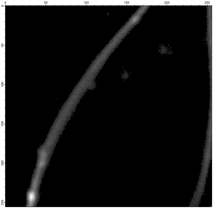

Then I apply a threshold : if V_avg of a wave is < 1, I don't use this pixel (and the corresponding wave)
=> removing the back ground and focusing on the membrane (with some extra spatial structures like vesicules I don't want)
see "03 - Mean of intensity with the 1 threshold.jpg"

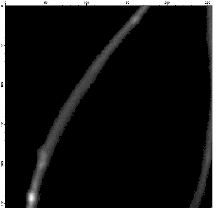

Then I remove manually the parts of the image I don't want => Mask matrix with 0 values where there is no relevant information (i.e. outside of the membrane, or inside the cell)
see "04 - Mean of intensity with the 1 threshold and after vesicules removed.jpg"

General comment:
You are presenting a reasonably complex task. While the overview is good and useful, it would help if you broke it down into elementary questions for which you are more likely to get answers.
Looking at your images it seems that this is not the classic "particle tracking" problem but rather boundary tracking. My hunch is that the noise in your images is high enough that comparing thresholded images is not a good idea. It might be better to apply some edge-detection technique (look at the documentation of ImageEdgeDetection operation) and compare the derived edges for the various frames.
Hi Djebulon,
depending on the type of movement of the membranes in your stack this can be quite complicated. But if there is mainly translation and rotation or skewing, you may try
ImageRegistration
. I tested it with your example data (
ImageRegistration /q /STCK /PSTK /TSTM=0/REFM=0/CSNR=0/skew={1,1,0}/rot={0,0,0} testWave = Ex, refWave=Ex0
, Ex is your stack, Ex0 is the first frame of the stack) and the result looks better than the original stack (at least in my eyes).
