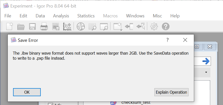

Additionally, when I create a wave over 2GB within Igor and try to save it as an Igor binary wave, I get an error message that the .ibw binary wave format does not support waves larger than 2GB.

The .ibw format is limited to 2GB. Igor can not write waves with data >= 2GB to a .ibw file.
You can save larger in a packed experiment (.pxp) file. If the wave data is < 2GB, Igor writes it in a .ibw format record in the packed experiment file. If the wave data is >= 2GB, Igor writes it in a special 64-bit format record in the packed experiment file.
You can write a wave or data folder to a .pxp file using SaveData operation. You can also do it using the Data Browser - select a wave or waves and click Save Copy. Igor writes the wave or waves to the .pxp file in .ibw format or in 64-bit format depending on the size of the wave.
