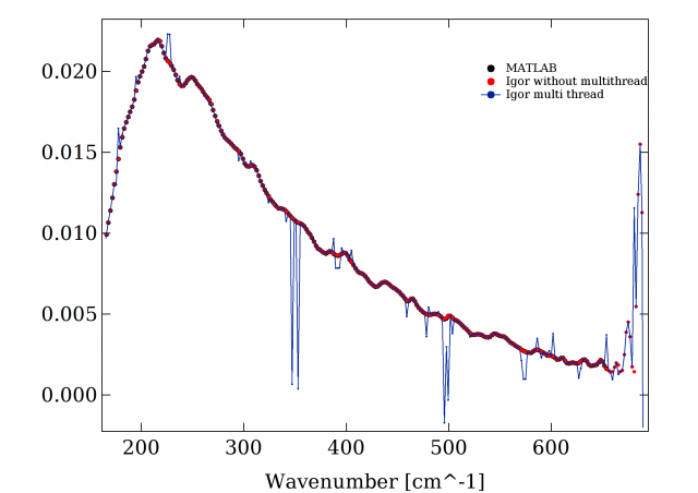

To treat my data I have a matlab script written by a colleague which I translated into igor and adapted to my needs. The procedure is quite fit extensive. The result of both programs are in pretty good agreement (without surprise). To enhance the speed I use a multithreaded code. However the result obtained with igor multithreaded code is a little bit more noisy (for the same conditions as far as it is possible to manage them) as it is shown in the attached file while the "normal" gives exactly the same result as the matlab script.
To be a bit more precise: Each x point is the result of the the difference of two different datasets proceeded by the following function.

Where is my error?

- Why is tmpwv passed in as an argument? Each thread will overwrite tmpwv - its contents are undefined.
- You reference a wave called fit_dumper. I don't see one being created. Remember that all threads have their own data folder hierarchy, independent from the 'standard' Igor hierarchy.

Great that fixed the problem. Indeed I have to create tmpwv in the thread. However your suggestion seems to be a bit "lighter", I'll give a try.
