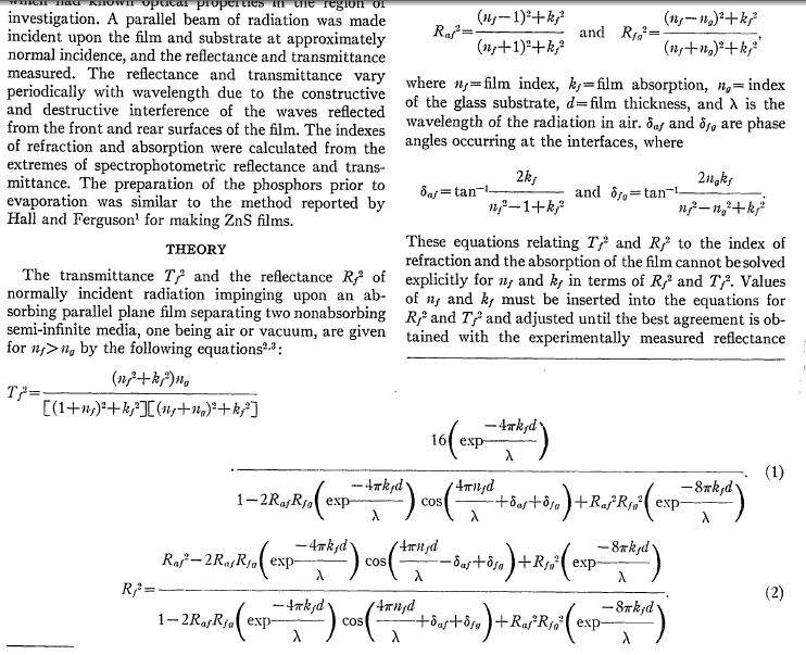

The equations I'm trying to solve, see attached image, are for transmission and reflection of light from a thin film on glass. The variables to solve for, nf and kf, are terms of the complex index of refraction for the particular wavelength being evaluated.

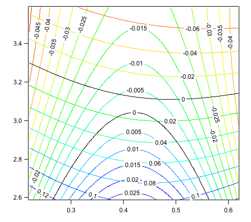

It not only gets chaotic, it goes through a region where there isn't any solution, at least within the range of parameters that you're looking at. I made a contour plot using your two matrices fcontour and gcontour, but put them on the same graph. I colored the zero contour black so that it stands out. The plot made by contour(356) is attached. You can see there is no intersection between the two zero contours.
The situation around contour(400) is OK- there is a discontinuity in the surfaces that is probably far enough away from the solution that with the right starting guess it would probably succeed. But the starting guess would pretty much have to be on the correct side of the discontinuity.
And the picture at contour(358) is just total chaos. You could probably get your solutions excluding that chaotic range by working from either end of the range toward the chaotic middle.
I added a function to your experiment file, DoManyContours(start, end), that steps through a range of values so you can watch a little movie of the changes in the contours. It is instructive to watch it pass through chaos and then recover :)
