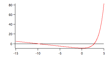

Make/D/N=2 coefs		// a wave with two elements for the A and B coefficients
coefs = {2.5, -10}		// These values produce a function with two roots: see attached graph
Make/N=1000/D junk		// Make wave for graphing the function
SetScale/I x -15,5,junk	// A little experimentation showed this to be a nice range given the coefficients I chose
junk = NewToIgorFunc(coefs, x)		// invoke the function to fill the wave with function values
Display junk			// make a graph
ModifyGraph zero(left)=1	// Turn on the zero line so you can see where the roots are

So it found one of the roots you can see on the graph. In order to find the other, you need to supply a bracket for the root:
FindRoots/H=0/L=-15 NewToIgorFunc, coefs
Possible root found at -9.9999
Y value there is 3.52694e-10
As a special feature, if your brackets are both positive or both negative, FindRoots will attempt (not necessarily successfully) to find two roots between:
FindRoots/H=5/L=-15 NewToIgorFunc, coefs
Looking for two roots...
Results for first root:
Y value there is 4.29281e-10
Results for second root:
Possible root found at 2.78071
Y value there is 3.05533e-13
One thing you can see from all this is that when finding roots, it is pretty essential to have some rough idea of the shape of your function. The graph is essential!
