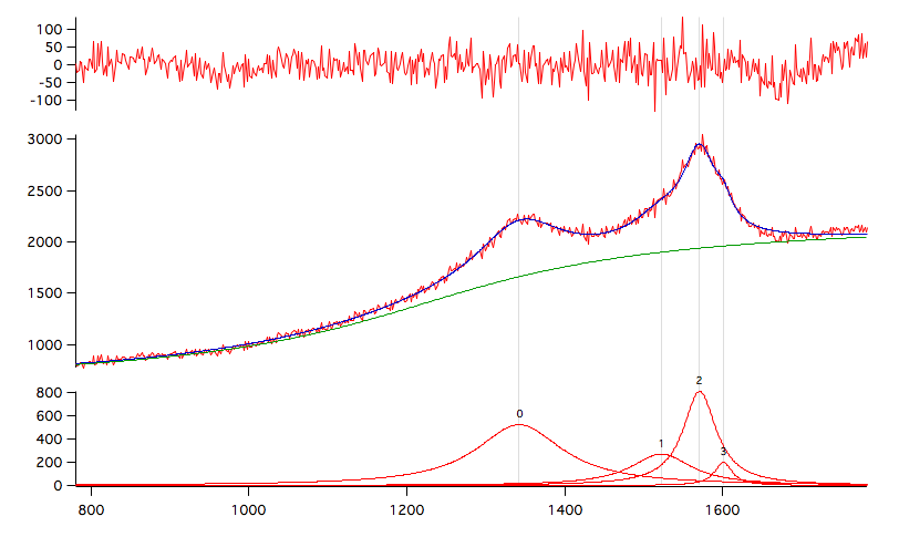

UglyRaman.pxp (50.48 KB)
I am no expert on Raman spectroscopy. I am just barely an expert on curve fitting.
What aspects of that data set are you interested in? The entire X range?
Do you know what kind of background you might expect? I know that in some cases you can get theoretical guidance even on the background shape.
My recollection is that one of our customers said something that I have remembered as suggesting that Raman peaks are Lorentzian. Don't take my word for it, though. I think your data set fits better with Lorentzian peak shape. I know just enough to know that Gaussian vs. Lorentzian is generally explained by different line-broadening processes. I have now exhausted my knowledge on this matter!
I have attached a fit to your data that I think is pretty good. But I cheated- I used an ArcTan baseline function that I wrote for another customer, and you don't have that one :) I think that customer was doing gas chromatography, so I don't know if it's justified in your case. And yes- I did fiddle some with the number of peaks. It looks like there might be another peak at the edge on the right, but I didn't include that. I think the peaks I used are all justified by "wiggles" in the data set.

If you use it, be aware that you have to enter initial guesses for the coefficients yourself- there is no auto-guess for a baseline function. But they are straightforward- y0 is the Y level at the left (low X value) end, x0 is the middle of the sigmoid shape, deltaY is the difference between y0 and the right end, and dilation sets the width of the sigmoid transition, with larger values making it wider. You probably don't have to be very accurate with any of the coefficients.

I did a lot of Raman work in the 1990's and early 2000's, but very little since then. My thoughts are are follows:
For a simple system (simple molecule or well ordered crystal, for example) the Raman bands are usually Lorentzian in shape. But, the spectrometer will have a finite resolution, usually imposing a Gaussian distribution on the measured band. If the resolution is of the same order as the natural width of the Raman band then I found a good fit using a shape that is a mixture of both Lorentzian and Gaussian functions. This was usually the case with the 520cm-1 band from silicon, which I used as my basic instrument QC before and after most experiments.
If your sample is less uniform (on the length scale that is relevant for the Raman band in question), then you may have a distribution of contributions to your measured spectrum, resulting in some (significant) broadening. The detail of this is very much dependent upon the sample in question.
As for the question of smoothing - this is a matter of opinion - personally I would only smooth data for presentation purposes, and then only if it was necessary to clarify my interpretation - any fitting would be done on the un-smoothed data unless I had a good reason to do otherwise (one example of the latter is a median smooth which can eliminate cosmic-ray spikes in the data).
For background removal/subtraction - I think it is important to choose a function which has a few parameters as possible. I like the look of the arctan function that John Weeks used for this particular case, but I am not sure whether it would be appropriate in general. It is a matter trial and error, unless you have an understanding as to a more appropriate function to use from your knowledge of the sample. [One interesting method is to use an excitation wavelength that is slightly shifted - the Raman bands will move with the excitation, but the background should stay more or less the same].
I don't think there is a single 'right' way to handle your data - the important thing is that whatever you do is sensible, and you explain what you have done (and why) in sufficient detail that others can understand and reproduce the analysis.
As for a book - there are plenty out there. Again it is all a matter of opinion as to which are appropriate or not. I can suggest, for example, 'Handbook of Raman Spectroscopy: From the Research Laboratory to the Process Line' Ed. Edwards & Lewis. Have a look at the start of chapter 7 for some discussion on smoothing and baseline removal.
For me, the most important thing is to clearly have in mind the specific question that you are asking the data to answer. If you get this straight, then the question of what is an appropriate analysis method will often become much clearer.
Finally, I had a quick look at your spectrum. I do not know what your sample is, but it reminds me of disordered carbon - the two bands are the 'D' and 'G' bands which are related to sp2 and sp3 moieties (it is some 20 years since I looked at this type of sample, so my memory may be a little rusty). Back then, there was much debate in the literature as to the detail of their origin.

Kurt, thank you very much for your detailed response. You are correct that the spectrum posted shows the D and G bands of graphitic carbon. Unfortunately, the problem I have is that my sample is heterogeneous and also changing with time, so no one background will always fit nicely. I'd like to fit each and every one of my spectra by hand with a background function, but that's simply not feasible. I have many hundreds of spectra for each and every experiment. (Usually 2-3 experiments per week.)
