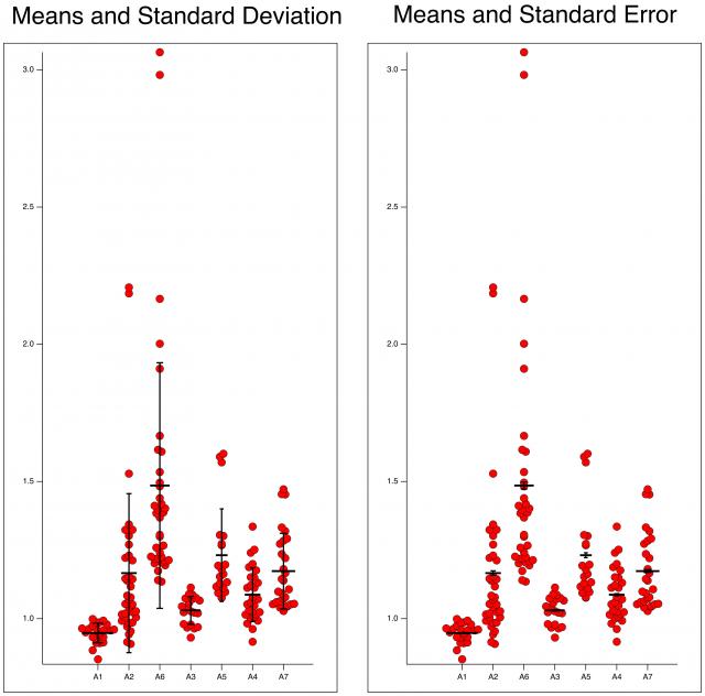

When make a Scatter Dot Plot together with mean values and Standard Deviation it looks fine. However, if I change to Standard Error the error bars actualy become much smaller than the true Standard Error. Is this a bug or am I doing something wrong. I enclose an illustration of the problem. The data in wave A6 has a Mean Value of 1.485, a Standard Deviation of 0.447 and a Standard Error of 0.075. The Mean Values and Standard Deviation are shown correctly in the left graph but the right graph indicates a Standard Error of 0.0128 (measured with Show Info) rather than 0.075.

I think that's a bug. I use scatter dot plot a lot but I always use s.d. for the error bars, but I can reproduce what you see in IP7.05 on macOS.
John, s.e.m. is stdev/sqrt(n). But even so, the standard error calculated by the scatter dot plot package is out.

Sure enough- the author of the Scatter Dot Plot package made the same mistake I did. I have corrected the error, and attached a fixed procedure file. You will find the procedure file in Igor Pro Folder:WaveMetrics Procedures:Graphing: Simply replace that copy with the one attached.
