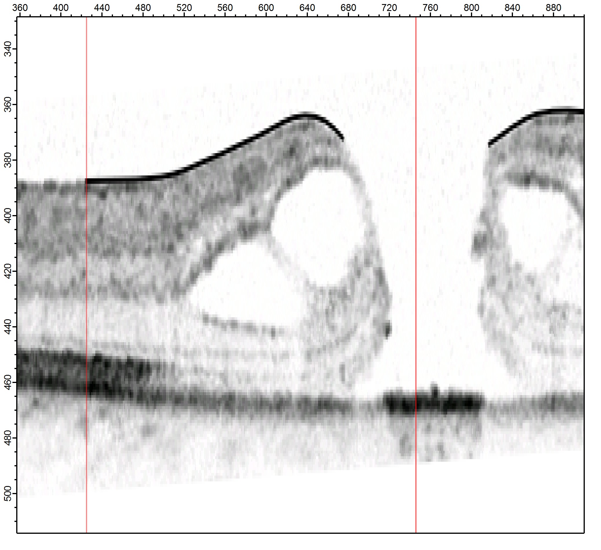

Attached is an OCT image of a retina with a hole at the fovea - I've traced the surface of this and the attached ibw files are the x,y data and line x=0 will be a centre line and rotation about y-axis.
This is where I'm heading following the earlier and easier problem...
Any help to move away from algebraic to numerical curves would be most appreciated
Colin
If your surface of revolution is described by the curve you see when you execute:
display wave5 vs wave4
I suggest fitting it to a simple polynomial and then computing the resulting surface as above. Start e.g.,
CurveFit/NTHR=0 poly 6,  wave5 /X=wave4 /D
Obviously you could work with the trace data directly but I suspect that your numerical derivatives are going to introduce sufficient inaccuracies that you are better off with the fitted polynomial approach.

colingrant wrote: I'd like to be able to do this to any curve with any generic (x,y) data; purely using only generated curve fitted data and the differentiated data of that curve fitting....
The curve fitting I suggested was appropriate for the retinal data that you sent. A 6 term polynomial is not appropriate for an arbitrary data set.
Returning to the initial problem, I suggest you consider the 2D integration as integral [0,2*pi] and integral [x1,x2]. The integrand itself is f(x)*sqrt[1+f'(x)^2]. Rotational symmetry gives you a factor of 2*pi for the first integral.
I suggested the polynomial fit so that you could avoid computing f'(x) numerically and squaring it. Your tracing data did not appear to represent a smooth curve which would affect the derivative and its square. Using the fit allows you to write down both f(x) and the derivative and then numerically evaluate the integral.
If you are not aiming at smooth data you can treat each line segment (x1,y1) to (x2,y2) as an independent segment revolving around the y-axis. For this line segment f(x)=a*x+b, f'(x)=a=(y2-y1)/(x2-x1). For example, suppose you have a simple line f(x)=x for x in [0,1]. This leads to a=1, b=0 and the integrand is x*sqrt(1+a^2) which gives you sqrt(2)/2. The surface area for this revolving line segment is 2*pi*sqrt(2)/2 or sqrt(2)*pi.
