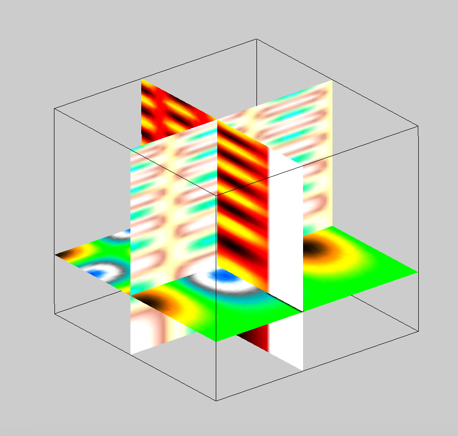

Thank you for your response. You are right that (a) and (c) in the example do not use transparency. My goal is to create an analogous figure, but with transparent regions.
I followed your instructions and attached an image showing the result. Unfortunately, the NaN values appear as white rather than transparent. I have already tried this approach and experimented with different settings, but I couldn't achieve the desired effect.
If I am not missing something obvious, I can send you my experiment. Let me know how you’d like to proceed.
March 4, 2025 at 12:48 am - Permalink
Thanks for the image but I really need to check your experiment. Did you enable transparency blend?
March 4, 2025 at 09:04 am - Permalink
