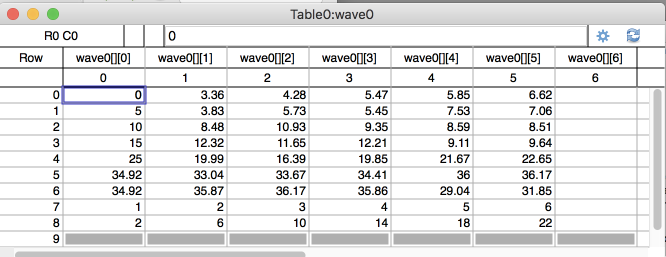

Thanks for your response. Below isa detailed account of my steps:

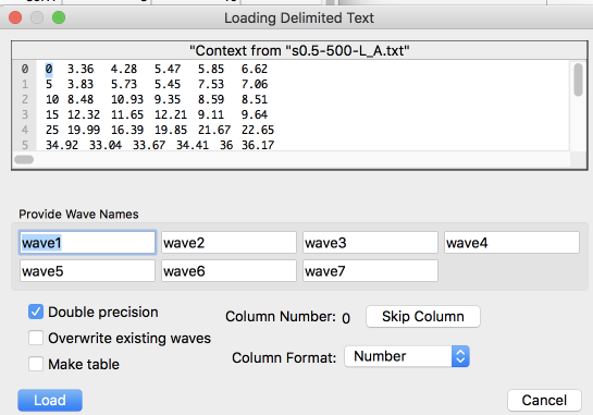

1. My data is written as delimited text, and I want to plot one row of data against another, as a 2D wave.
2. In Igor, a regular use of Load Delimited Text yields a table as shown in Attachment 1.
3. In Igor, Load Delimited Text with "Load columns into matrix" checked yields a table as shown in Attachment 3.

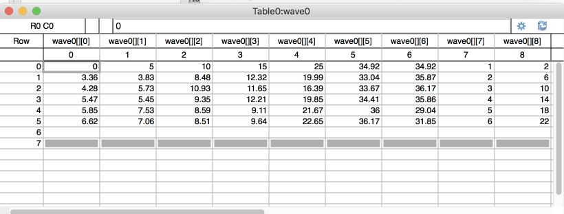

4.Executing "MatrixTranspose Wave0" yields the transposed table shown in Attachment 2.
5. However, no plotting seems possible from this table.

So it it more a plotting issue? Loading and transposing seem to work.
Try
make /N=(5,10) test
test[2][]=2*q
test[4][]=q+2
edit test
display test[4][*] vs test[2][*]
In case you want to plot columns against each other, it would be
display test[*][4] vs test[*][2]
Have a look at
displayhelptopic "Subrange Display"
HJ
