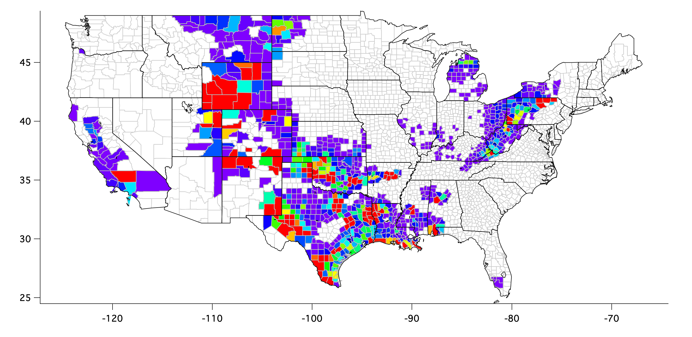

I've used the following macro to achieve something similar. This makes a drawing object which can be filled, though it sometimes fails if the outline of the feature is too complicated. I used a similar macro but passed it a fill color based on another parameter to produce the attached map. A little clunky, but it achieves the desired result.
macro FillFeatureOnMap(latWaveStrToFill, lonWaveStrToFill)
string latWaveStrToFill, lonWaveStrToFill
prompt latWaveStrToFill, "Lat wave:", popup wavelist("*", ";", "WIN:") // waves in top graph in current data folder
prompt lonWaveStrToFill, "Lon wave:", popup wavelist("*", ";", "WIN:") // "
Silent 1; PauseUpdate
SetDrawLayer UserBack
SetDrawEnv xcoord= bottom,ycoord= left, fillpat= 1
// DrawPoly NewMexico_lon[0],NewMexico_lat[0], 1, 1, NewMexico_lon, NewMexico_lat // hard-coded example
DrawPoly $lonWaveStrToFill[0],$latWaveStrToFill[0], 1, 1, $lonWaveStrToFill, $latWaveStrToFill
ShowTools/A arrow
Print "Click on tools, select the drawing object on the map, and chose a 'Fill Color'."
