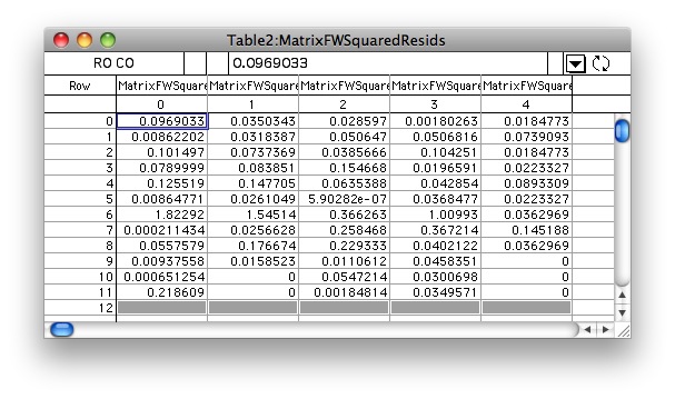

I run into problems when segment length times the number of segments is not equal to the length of the time series, as does happen when the segment length is 10
and the number of segments is 1 or the segment length is 3 and the number of segments is 3. See the changed code and the attached output (= MatrixSquaredResids).

The matrix in the attachment should show zero values in rows 11 and 12 of the second column as well as in rows 10, 11, and 12 of the fifth column. Instead of that
the columns repeat the values in the same rows of column 1 and 4, respectively. Problems like the one shown above turn up when the the segment length is not a
divisor of the length of the time series.
Does anyone know how I may show the squared residuals correctly also in situations where the segment length fails to be a divisor of the length of the time series?

Eduard,
I'm not completely certain this is the source of your problem, but my hunch is that it is. You should change
Make/O/N=(Length) FWResidsSquared
to
Make/O/N=(Length) FWResidsSquared = 0
Overwriting a wave with the /O flag leaves the contents unchanged, unless you change the wave's dimensions. Even then, some elements will retain a non-zero value.
Jeff
