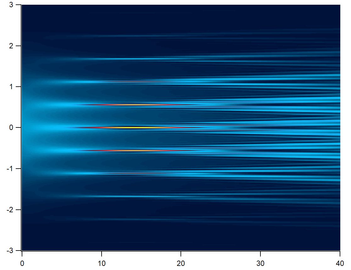

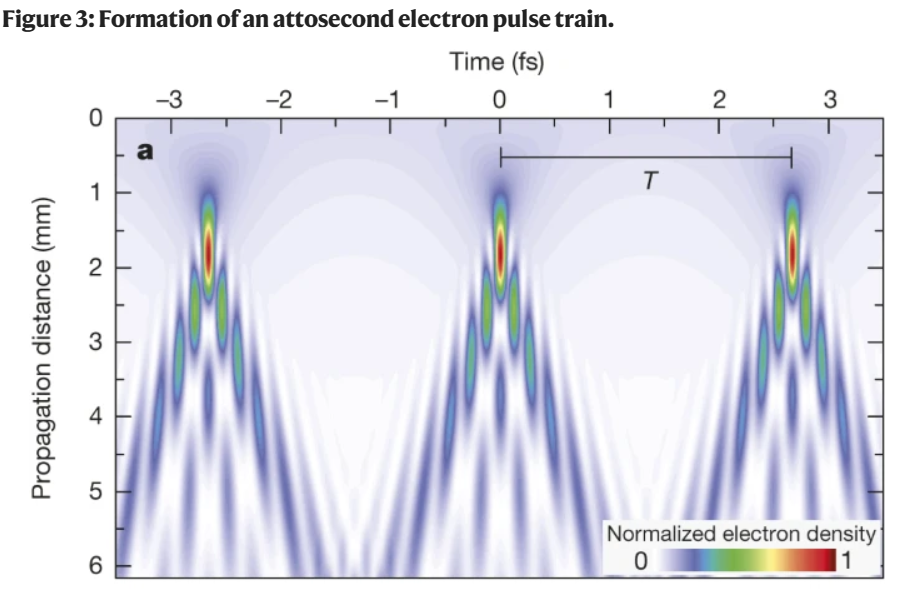

I want to simulate PINEM electron density probability as a function of time and position after interaction with near field. But the function ffinal(twave,zwave,yw) always results in a zero yw wave. Basically it is the time-dependent momentum space electron wavefunction Fourier transformed to position space.What I want to get is shown in the attachment. It should be magsqr(yw). But yw in my code always equals zero. What's wrong with my code? Many thanks!
