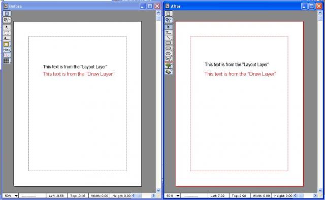

In Igor 6.0 and onward, when I move an object in the "Layout Layer," and then click the "draw tools" button, the dotted line marking the Layout margin changes to the same color as some of the text in the "Draw Layer" (see attached screenshot). The dotted line returns to its original black color after closing and then reopening an Igor Experiment.
Is this a bug? And if so, is it a known issue? My computer is running Igor 6.3.4.1 on an PC with Windows XP.

Yes, this appears to be a bug. I will look into it.
A quicker workaround is to kill the layout, saving it as a recreation macro, and then run the recreation macro.
