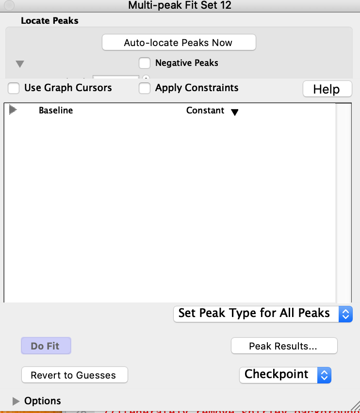

I am currently using the multipeak fit 2 package with Igor 8 pro. I found there is an error when I tried to open the hidden area by clicking the triangle icon:
** DefineGuide gave error: Invalid guide name.
And the result is shown in the picture.
Can anyone help me to solve this?
Thanks,
Yes, just before the 8.04 release I "improved" Multipeak Fit and caused the problems you see. Please email support@wavemetrics.com and I will send you a fixed replacement. My apologies.
