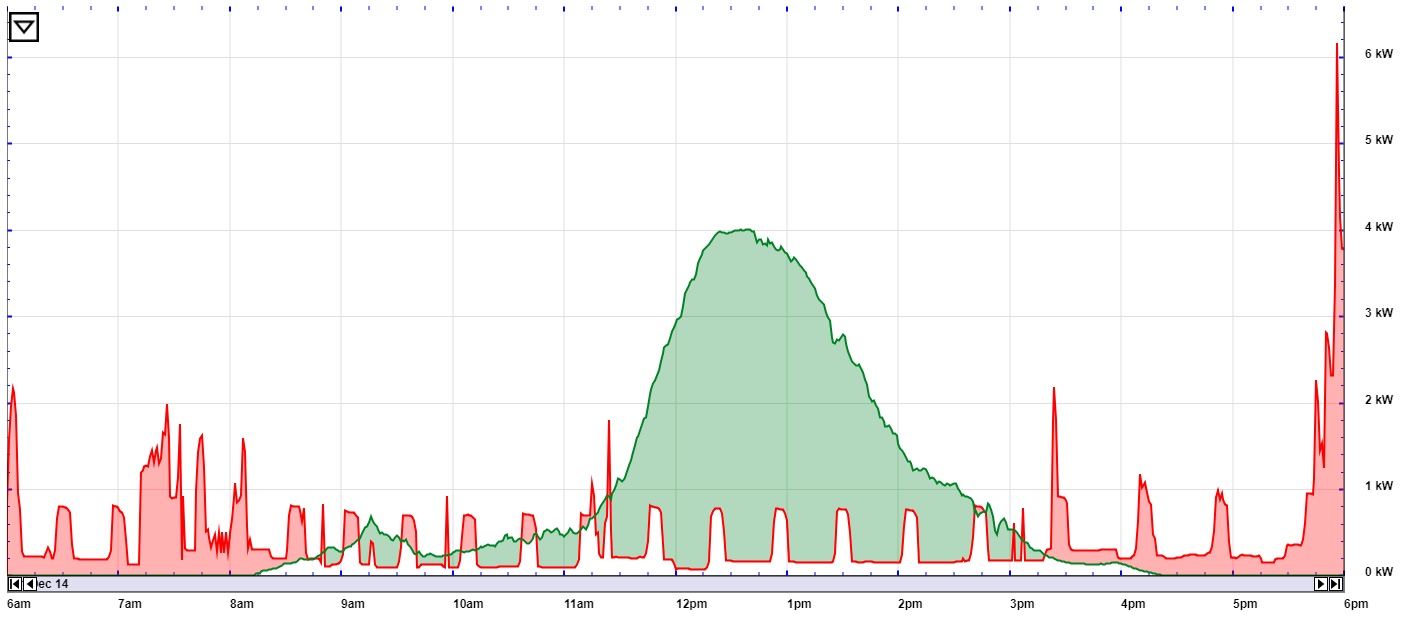

Is there a straightforward way to reproduce the style of the attached plot in Igor Pro? In particular, where the red wave overlaps with the green wave, the color is white. I suspect there is an easy way to do this by arranging waves and choosing the correct mode/fill, but I haven't been able to figure it out. Any help is appreciated. I have Igor 7, so I can make one of the waves translucent; this approximates the effect I'm after, but I would prefer the look of the attached plot.

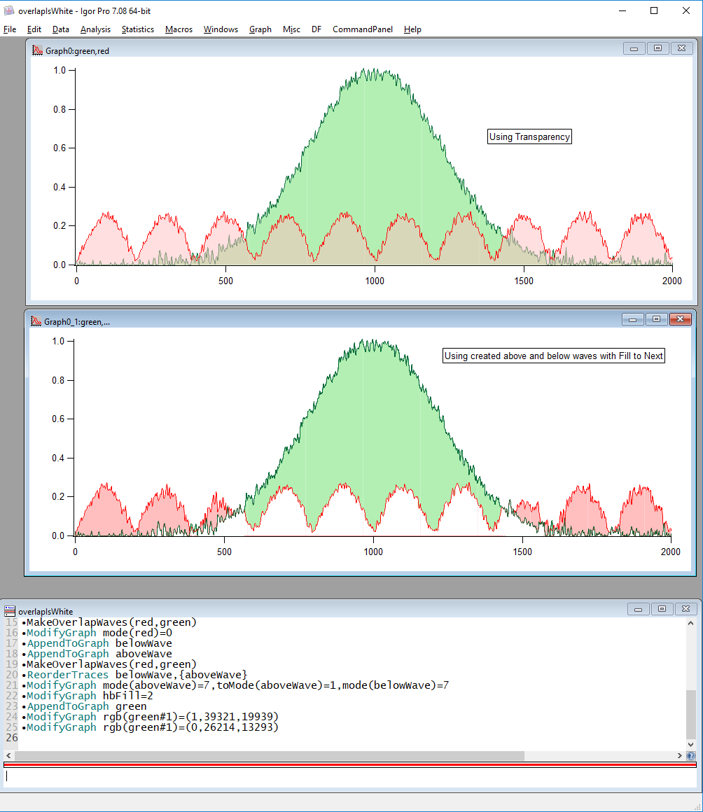

To do what you want without transparency, you need to splt the front (red) wave into two waves which add up to the value in the red wave. Here's a function that does that:
I've attached an image of the results compared to using transparency, as well as my demo experiment.
