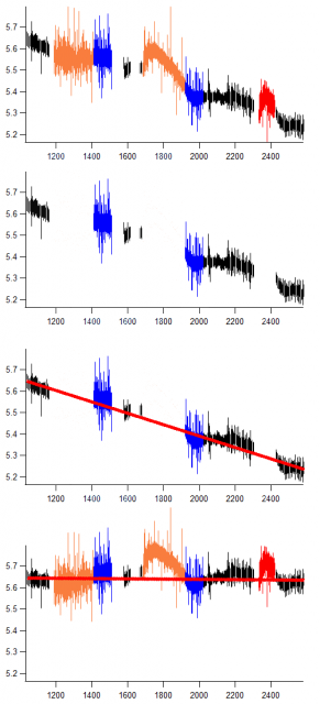

I have a data set which I want to modify in the following way: (please see image attached).
Essentially, it is a collection of waves that share the X axis, which is time. What I want to do is, I presume, "baseline adjustment", and there are few packages that do exactly that. However, the packages that I tried only deal with individual waves. In my case, the dataset in the example has 292 individual non-overlapping waves, each wave with the same delta of 0.0005 and different number of points, with some NaNs here and there, and with no data points in between each wave.
If I simply concatenate all the waves the X values for each wave and for missing data between waves are lost, and slope on my fit will be different.
As I see the problem now, I need to populate all the empty space in my graph with NaN points, and then concatenate waves, together with their NaN "spacers", to get one big wave that I can do baseline adjustment on. However after this I'd need to separate waves back to do analysis on the interesting parts (since I'm interested only in waves colored in orange).
I looked through the different topics, and what I could do is either append NaNs to each of 292 waves and then concatenate, which may result in some (acceptable) imprecision around the boundaries of each wave due to slight offset in time points - which I'm not sure how to approach. Or I'd need to do something like "Mass XY-pair to waveform" conversion, to interpolate all my data to one new wave - which I don't know how to do either (and I would like to avoid resampling altogether, if possible). Or maybe there is a way to do baseline adjustment on multiple waves at the same time, and I just don't know it yet - this would be best since I wouldn't lose individual waves that are convenient to analyze. Tony's Baselines_5.ipf package appears to be doing some of the work with "All in One" function fitting between two hand-placed markers, however it throws an error with waves that contain NaN points inside them.

It looks like you’re working with x-y wave pairs. In that case, you should be able to concatenate, and perhaps sort by x values, without losing any data since you say they’re non-overlapping. That would give you an x-y pair for fitting.
It also looks like you're fitting a line. Once you've done the fitting and have the fit coefficients, you can subtract the line from whichever data set you like, so you could duplicate the 'orange' data and do something like
OrangeDataBaselineSubtracted = OrangeData - coef0 - coef1*x
or
OrangeDataBaselineSubtracted = OrangeData - coef0 - coef1*xwaveForOrangeData

tony wrote: It looks like you’re working with x-y wave pairs. In that case, you should be able to concatenate, and perhaps sort by x values, without losing any data since you say they’re non-overlapping. That would give you an x-y pair for fitting.
or
I managed to produce a properly spaced single concatenated wave that I can fit with Baseline or Spline tools.
I gather that the "_coef" from Baseline tool provides slope and intercept, and "_BL" the values I need to add to my data for offset to 0 and slope correction?
How should I approach correcting my initial separated waves now that I have them spaced? Should I just add the "_BL" coefficients to everything?
If you do the fit yourself you will have access to the fit coefficients. So, for instance, if you fit a line to your data using the analysis->curve fitting menu, the coefficients will be recorded in the history and saved in a wave w_coef. You can use these to figure out what value to subtract from each point in your wave.
The baselines package uses CurveFit too, so you can look for that same w_coef wave after fitting a baseline to find the fit coefficients (for most of the fits - for the 'line between cursors' baseline you can instead look in the wavenote of the baseline to find the cursor positions).
I'm not sure exactly how you want to set up the fit and what you need as output, so it's hard to be more specific than that. It looks to me like you have sparse patches of data spread over some time period, and you wish to fit a linear trend through (all?) of the data, and then perhaps subtract that trend from each subset of data?
