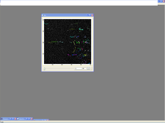

So I have plotted a number of waves on a movie (say 100 frames) using
 AppendToGraph
and it works fine. Just as an enhancement to the visualization, I would like the waves to appear as I vary the frames. I tried using
 DelayUpdate
but in vain.
The image shows current plot. I want the lines to appear as I move the frames.
Any help is greatly appreciated. Thanks!!

Are you saying you want 1 wave to appear in each frame? In a for loop append 1 wave, then addframetomovie. loop until all waves are plotted.

741
The screenshot in your first post looks as though it was created using my Localizer package, and it appears as if you're using particle tracking. I assume that you want to animate the particle tracking.
If that is the case, I've tried to include support for this natively - simply show the tracks using the GUI controls, and make sure that "tracks are constructed with movie playback" is checked. Then go to Macros -> Localizer -> Save topmost movie as, and choose "presentation movie".
