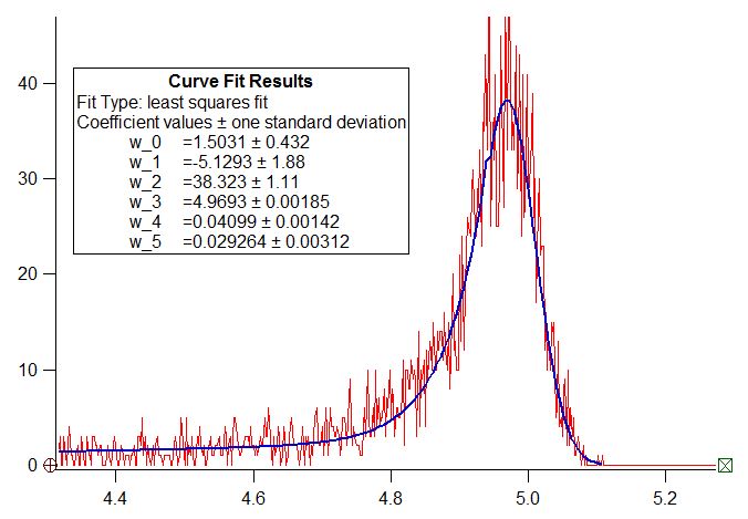

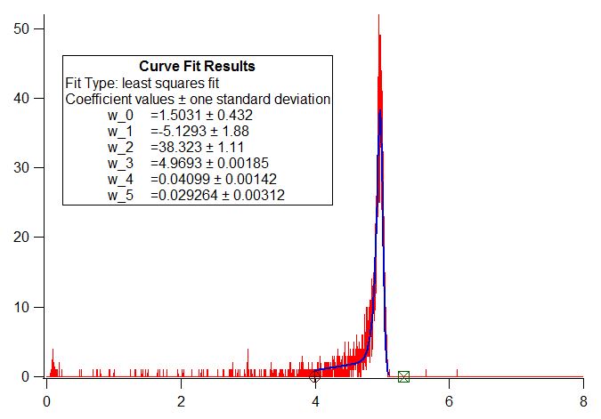

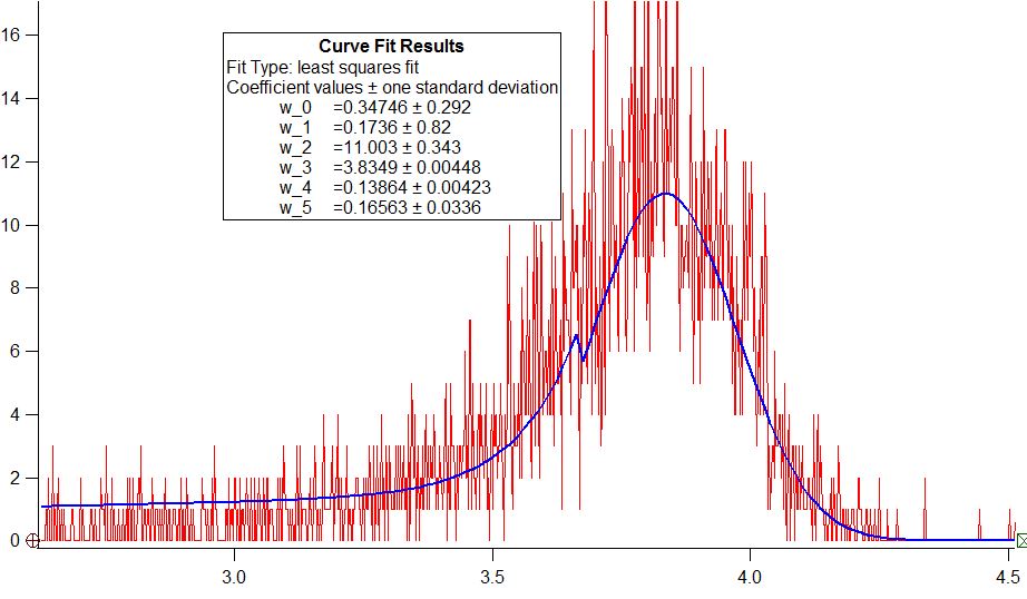

I've been working on a simple function to fit a Gaussian peak with left-tail asymmetry. For whatever reason, I can't get the MultiPeak2 to fit it for me properly without making both the Tau and Width negative, which fits it nicely but gives me nothing useful for fit values.
I've made an attempt at using a step-function to have the program fit the low-energy tail side of the peak with a modified Gaussian, and then at the point where the shape deviates and begins its Gaussian form, it switches to fitting with a regular Gaussian equation.
The problem I'm seeing is a sort of jump-discontinuity between the end of the modified Gaussian and the beginning of the standard Gaussian fit. I've been trying to figure out a way to fix this, but have been unsuccessful. It's small, though, and only noticeable if zoomed in on the peak. I'll attach a jpeg of one of the graphs, the code, as well as my Igor file.
Thanks.

Are you forgetting to add the background in the case where the tail is used?
Also, try this below. The coding x = test ? yes answer : no answer should be faster than an if ... endif test.

In addition, my understanding of tails is, they start at a defined point on one side or the other of the peak. In this case, w[3] - w[5] = C, where C is a defined value that in most cases is ZERO. IOW, are you allowing too much variation in the peak definition?
Finally, I would wonder why you are taking this approach? The S/N ~ 3 in your spectrum. This is just at a borderline where reasonable people say they can define a peak, let alone define a peak with any form of asymmetry. IOW, do you have enough confidence that your data supports a tail gaussian? Have you tried comparing the uncertainty budget returned in just a simple gauss with that from your tailed gauss?
jjweimer wrote: Are you forgetting to add the background in the case where the tail is used?
I am not entirely sure if my method was appropriate, but I added the background on the tail side of the peak and did not on the right side, since the left tail is positively offset while the right side of the peak returns to zero. If I have the bg on both sides, then the Gaussian fit extends over a region of nothingness. See below:

I'm certainly not an expert on asymmetric Gaussians, but to my understanding, in alpha particle detection it's characteristic of peak shapes due to overlapping. I've tried setting my step parameters to x=w[3] rather than w[3]-w[5], as well as letting w[5] go to zero. The fit function still returns a small value on the range of 0.02 - 0.07, depending on which peak I'm fitting. I've tried what I can think of to try varying ranges of peak definition.
I have also used the regular Gaussian and I do get better fit errors with the modified Gaussian form. The sample was not recorded for long enough to get adequate statistics, unfortunately, so I'm working with what I have. The other peaks that I'm working with are more clearly defined with left-tail asymmetry, as these are all attenuated by various filters of different sizes and material (aluminum, tin, and nickel). I'll attach a jpeg of the nickel attenuation, which shows much better tail-asymmetry since it has more counts than the aluminum, which is shown.
In the nickel attenuated spectrum, the little jagged shape in the Gaussian fit is less exaggerated, which I believe is due to better counting statistics.
Thanks for your response. I'll try some of these ideas out and see how it goes.

Your background is a linear sloping line. Should it not go from the far left to the far right of the peak regardless of whether the peak has a tail or not? You have not removed the background from the tailed peak, but you do remove it from the normal peak. I suspect that this is why you get the discontinuity that you are seeing at the point where the tail starts.
Hammy wrote: ... The sample was not recorded for long enough to get adequate statistics, unfortunately, so I'm working with what I have. The other peaks that I'm working with are more clearly defined with left-tail asymmetry, as these are all attenuated by various filters of different sizes and material (aluminum, tin, and nickel).
Thanks for the clarification. I was thinking in spectroscopy terms.

But I have to agree with Jeff that the background term is suspect. It's not in the quoted equation included with that reference, and if you disable it, or add it also to the Gaussian, the discontinuity goes away.
I have attached another copy of the experiment that has the background included all the way across, and not included at all, to the Sn_xxx fit. I personally see no compelling reason in that one data set to include the background, and it is clear that the background is the problem. Without background, the peak height isn't quite as good a fit, but removing weighting makes it just as good as the others. But fitting counting data without weighting introduces a bias, as we all know (right?).

Sorry for the delayed response. I actually tried adding the background to the entire fit, as JJ had suggested and like you already did, and found the same result. I didn't understand clearly enough what the effect would be of having it on one side but not the other. However, I did notice that once I added it to both sides, it did fit the little jagged spot in the peak of the fit, but it did not change the results at all. Not sure why that is, but the fit looks good and Chi^2 looks good.

I am still puzzled that you get a spike in the curve even after using the background over the entire spectrum. That suggests to me, something is disconnected in the logic test that is done within the function during the fit.
I am otherwise glad to hear that you are making progress.
