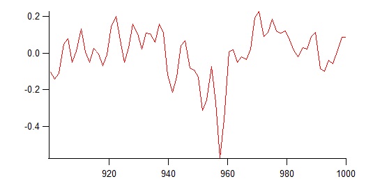

I am calculating the second derivative of a particular data range regarding Raman spectra both with igor and matlab....I noticed that the amplitude is higher in Matlab with respect to igor.....it is also likely that the position of a peak revealed in the second derivative has 1 wavenumber difference between matlab and igor....this seems a bit strange to me since its the same data set. Any suggestions?

i found out how to do it....however, using backward or forward differences solves the problem partly.....now the second derivatives seem a lot more similar but there is still a problem.....using matlab i get maximum negative values up to -3 in the second derivative, while with igor pro up to -2.....i am trying to understand why is that.
