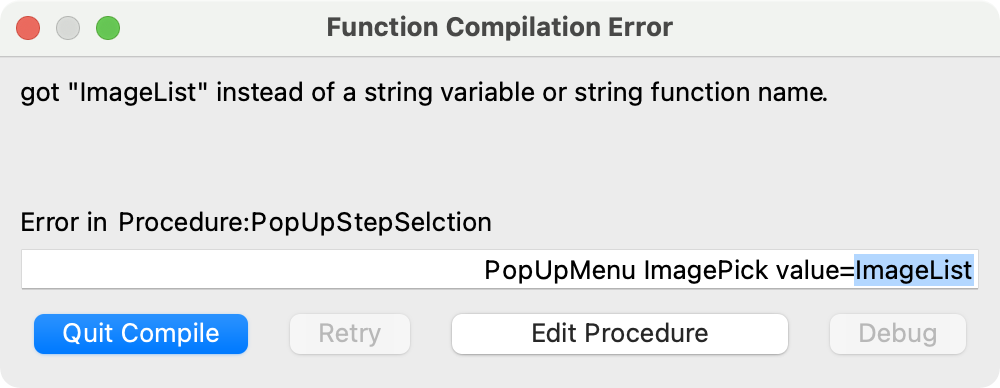

Working on simple interface that filters a directory list of images bu key words in the filename.  But getting a compilation error that I don't quite get.
This button controls the key word filter. The error is when I try to set the filtered list to another popup menu where the user can pick the individual image. The compiler is flagging an error saying that Imagelist is not a string or string function.  But I have declared it as string.

			PopUpMenu ImagePick value=ImageList //this is where error is identified

This does not and the only difference is that I assign the result of the indexedfile function to an intermediate string variable.

The help for PopUpMenu shows many scenarios for setting the PopUpMenu value, and the version that compiles is the recommended one in your situation.
If you need to use a local string variable as the value, the syntax is rather convoluted (for historical reasons):
String ImageList = "\""+IndexedFile(DataFolder, -1, ".tif")+"\""
PopUpMenu ImagePick value=#ImageList
