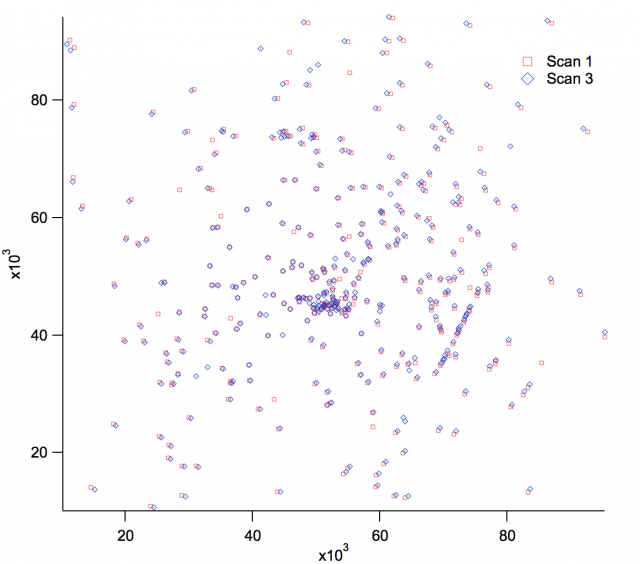

The problem: I have two sets of particle data from a defect inspection tool and the question is what particles were added (or removed) from the pre and post measurements. The issue is that the substrate is hand loaded into the tool so the coordinate systems are off a bit with an X and Y translation as well as a rotation. The particles may also have shifted slightly between measurements. So how do I correlate the frames of references between the data sets and line up particles that were there originally and which are newly added? See attached image for the representative data.

The attached image looks like it might be a wave/vector of coordinates, rather than an image matrix. If it is, I would create an image first from those coordinates, and then use ImageRegistration as A.G. suggested. This can be done straightforwardly in a loop.

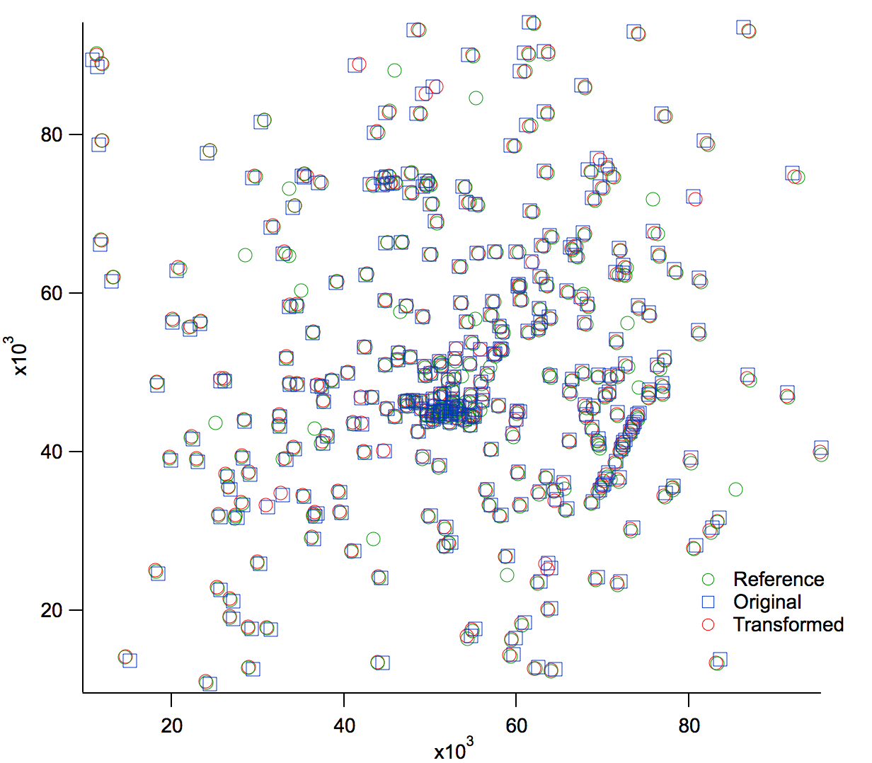

I tried the method using image registration and it works, but.
The are some important things to keep in mind. My data was vector so when I create an initial graph and then save it as image care must be taken to understand the reference point for the rotation is the center of the image which if I included axis and labels was to simple to translate back to the original coordinate system. So I created graphs without axis by compressing the margin to almost 0 (you cannot use 0) in the modifygraph dialog box.
Then I needed to convert the pixel displacements to the units in the original graph coordinate system.
