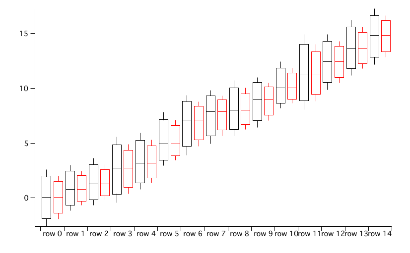

Unfortunately, that routine wasn't designed with multiple box plots in a single graph in mind. Making the whole, complicated thing accommodate that would be pretty complicated.
I was able, with a great deal of effort, to append a new box plot to one I had already made. Here's what I did:
0) I used a text wave as the X wave so that the box plot is a category plot. I don't think it will be easy to do it any other way.
1) I copied the code for the fBoxPlot function to the main procedure window. I renamed the function fAppendBoxPlot and changed "Display" to "AppendToGraph" somewhere around the middle of the function.
2) I made a second independent box plot, being careful to use a different name for the result waves. You have already done that by invoking fWavePercentile with different strings in the first parameter.
3) You will need to make the starting plot using fBoxPlot; I did that just by using the control panel to make the first plot;
4) Use the fAppendBoxPlot function with the starting plot as the top graph. Use the command you use above substituting fAppendBoxPlot for fBoxPlot and "P_F2" for "P_F1" and then again with "P_F3".
5) You now have something of a mess... Double-click any trace to bring up the Modify Trace Appearance dialog.
5a) Find the last trace of the first box plot. Since you aren't using outliers, that would be P_F1_25. Change the Grouping mode to None. Do it for the P_F2_25 trace also. This will make the boxes occupy different slots in the category bar space.
5b) The boxes and median lines are actually X error bars. One by one, select the median traces (P_Fn_50), un-check and re-check the Error Bars checkbox to bring up the Error Bars dialog. Change the X +/- setting to something narrower. Since you will have three boxes, you might choose something like .15. I'm not sure- you will have to experiment.
By now you should have a box plot with three data sets. Since the Graph->Modify Box Plot control panel doesn't expect the extra traces, etc., you can't use it to modify the appearance of the plot. You can use the Modify Trace Appearance dialog to change line thickness and trace color.
Unfortunately, filling the boxes on a box plot is done by adding colored rectangles as drawing objects. It is a royal pain in the neck (or other body part) to do it manually, and the box plot code won't do it correctly in this case. Probably you will have to do without. Maybe you could add colored fills to the error boxes in a drawing program if you export the graph in a suitable format.
I have attached a PNG of the graph I made.

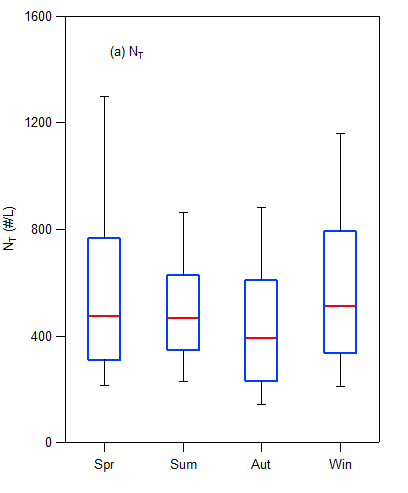

Thank you so much for your great effort. I can maybe change my question and modify the input that I use, so I won't have to work each data set separately. My new question: What if I have three time series on one graph and analyze them together. I can do it by using the control panel but couldn't find how to do it writing a procedure. I attached one example that I made by using control panel. The main problem is, I don't see any commands on the command window when I use the control panel.

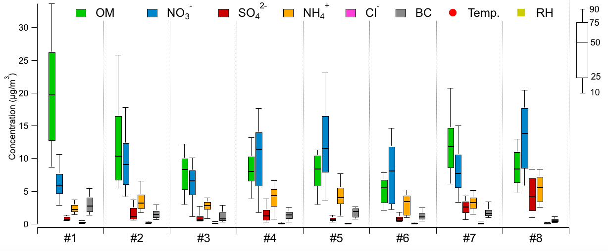

It's probably a bit late, but I encountered the same issue lately. One practical way could be to manually build the boxplot as long as you have the percentile data (let's say 10, 25, 50, 75 and 90).
then:
- make a category plot of all percentiles
- p10 should be: Marker "-"/ no grouping / black
- p25 should be: sticks to next/ Draw to next / black
- p50 should be: Bar to next / Draw to next / colored
- p75 should be: Bar to next / Draw to next / colored
- p90 should be: stick and marker "-" / Draw to next / black
if needed, reorder the traces (10-25-50-75-90)
this way, I have been able to build the enclosed graph.
I haven't written a procedure to do it automatically, but I guess it is rather simple. Although I used the boxplot package to calculate all the percentiles, I guess it is possible to implement this in a function.
hope this helps someone.
J-E
