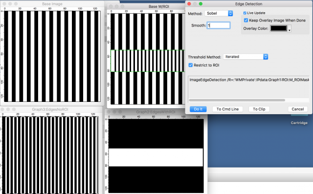

Edge Detection with ROI Broken(?)
I use the edge detection dialog with the live display so I can test out various algorithms available. When the dialog box is open and in live mode it seems to work as expected both with and without an ROI. I then select do it and look at the W_imageEdges wave to see the result. When I do not have an ROI enables the resulting wave (image) matches that during the dialog box live display. However, if I use an ROI and the resulting wave/image does not match at all what is seem during the dialog viewing.
Is something amisss or is my exception incorrect?

This has been fixed for the next IP7 and IP8 builds.

I understand it was not a trivial problem. Great work and response as always.
