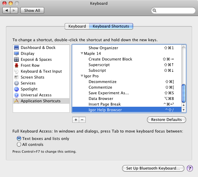

In addition, go to your Preferences control panel. Open the Keyboard preferences. Go to the Applications sub-menu. Add Igor Pro as an application. Define your keystrokes accordingly. See the attached image. This is under Snow Leopard, but it should be similar enough in Lion. What I have is equivalent to control-shift-/, where shift-/ maps to "?".
