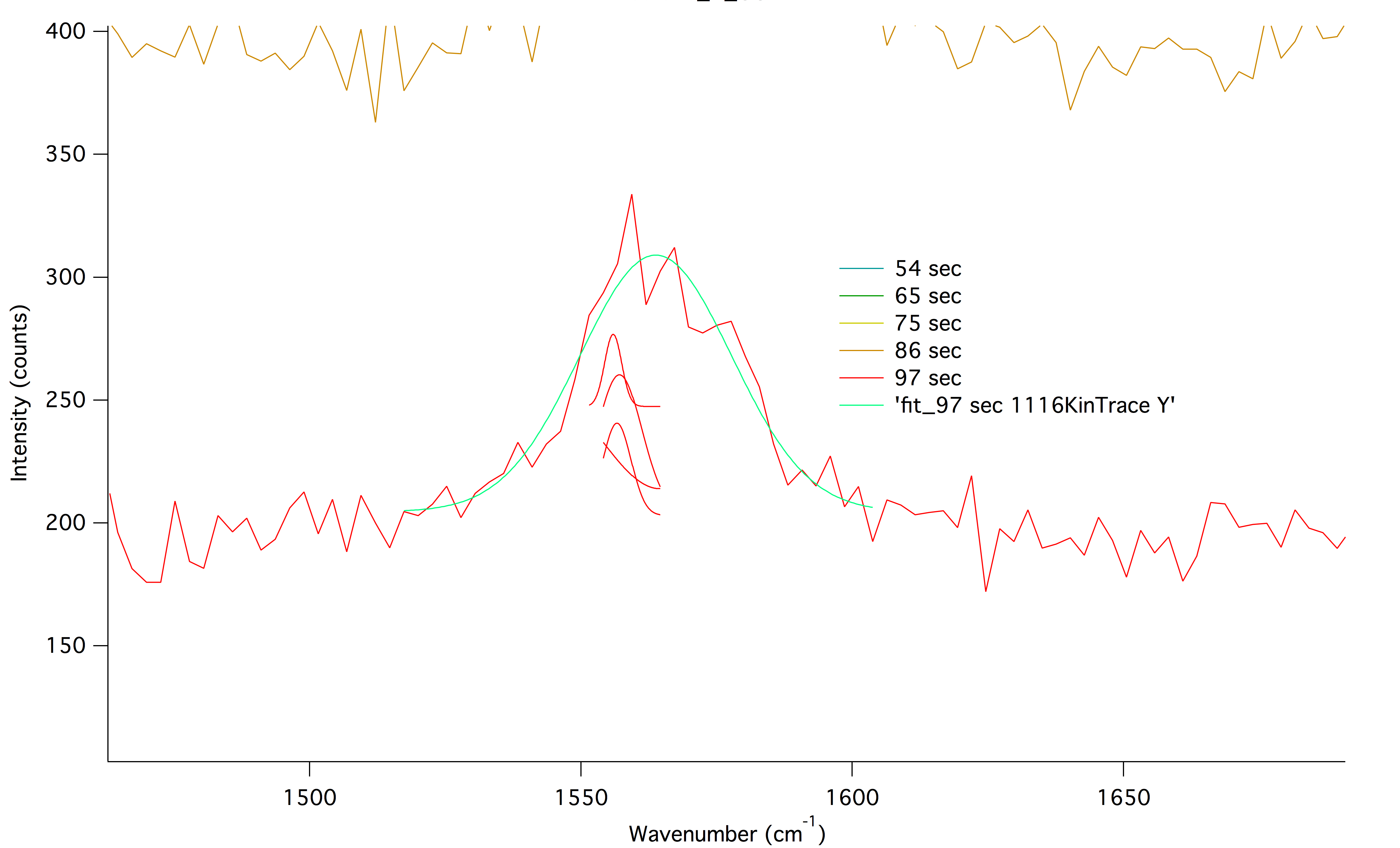

I'll attach a picture. Keep in mind, this is a very blown up section of my graph focusing on a very small peak. Zoomed out the data looks much... better. And generally our peaks are much higher, but we study kinetics, so sometimes peaks disappear, and I have to account for it.
You can see in the graph the raw data (red/spiky and mustard yellow offset above). You can see the initial fits (tiny red traces inside of the peak). There are multiple fits because there are 5 spectra on the graph, and I didn't bother to offset the fits (these are very much initial graphs, from here we decide which spectra to use and make publishable spectra from there. These are more to show me the overview of the experiment.) You can see how they like to fit just one POINT of noise, instead of the whole top of the peak. You can also see my "less accurate" solution in green. Sure, it's pretty accurate now, but if I have a sloping baseline or an asymmetric peak, it'll be further off. It's obvious that there is a peak there (we know there is, we can observe it growing), it's just getting the program to see that is a bit harder.

I think you're asking the fit procedure to do too much with too little information...in fact if all your data is sampled at that same spacing it would appear you're fitting 4 parameters (offset, center, width and height) with 4 data points...I guess Igor doesn't complain until you have one more parameter than data point, but that's not generally a good idea. I think KurtB's suggestion to only fit a portion of the peak was more intended to pull out a good peak center and position of the highest point from a peak that may not be well separated from its neighbors, or sitting on a steep sloping "baseline" caused by the tail of the Raleigh scattering or fluorescence. Your baseline subtraction seems to working well (if I understand correctly the red data is pretty much sitting on a zero baseline that only reads 200 because of the trace offset) and there are no interfering features around, so you're doing yourself no favors fitting over such a small region. You also probably shouldn't let the width vary, unless it really does change across your different experiments. Holding the width to a wider value (presumably determined from a fit to a stronger signal, or a known instrument resolution if you think the "true" feature should be narrower) will prevent the fit from honing in on a single noise spike.
I think you can also see in those other bad fits what I was getting at with the baseline: By not including any data away from the peak and letting the fit adjust the vertical offset and vertical height, some of your fit results are small peaks offset upwards and others are large peaks offset downwards. Better to widen the fit region, or if the baseline is sloped, automate a procedure to find the best single offset value (average of the outermost points e.g.?) and hold the value fixed when you fit the peak.

Yes I agree with you. Our baseline is nice in this spectrum at this point, but that is definitely not always the case. With multiple peaks to look at, and multiple environmental conditions producing more blackbody radiation (and therefore making our baseline terrible) I need my program to be able to deal with all of it. Now you see why I'm writing this in the first place. However, the important data that we care about generally has good signal, so these functions will never see the light of day during processing of those those.
And unfortunately, the width of the peak will change across experiments, depending on a lot of factors. Not to mention the other peaks I look at are pretty broad. However, the "average width" is a parameter that is input before the program starts, so it's easy to change.

I suggest, as eluded to by ikonen, that you put some Constraints on the fit parameters, especially width and centre. You should have a good idea what realistic limits are for these from your experience of looking at the data, and this will reduce the tendency for the fit function to home in on a spike or other unwanted feature in the data.
As an aside, you said in an earlier comment that you have a resolution of about 0.5cm-1. My quick eye-ball of your plots suggest you are sampling the spectrum every 2.5cm-1. It may be worth checking your instrument settings to see what is going on here.

You guys are right. I'm going to work on both putting constraints on the peak position and width, and I'm also going to use the previous time's fit as initial parameters as the fit doesn't change much between time data points. (Remember this is for a kinetic trace, watching a peak grow in or disappear.)
I came up with the .5 cm-1 number from observing the peak position of the internal Si standard, however that number was the peak position as reported by the program itself, I believe you are correct. I misspoke.
