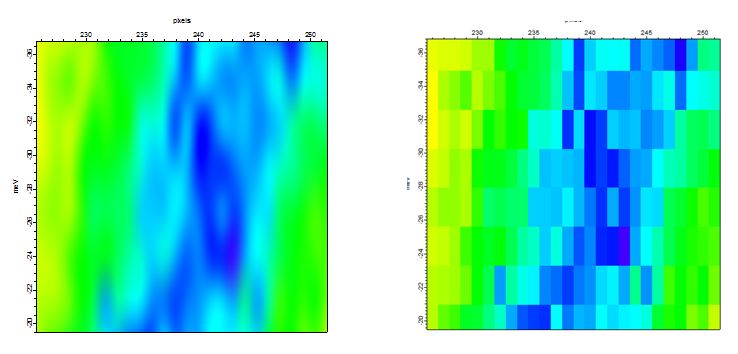

Actually, when I copy the graph into powerpoint 2010, the figure I got is like left one (please see attched JPG file), but actually i want is the right one created in Igor. It seems like the figure was smeared by something when I copy the figure. What's the problem?

I don't think PostScript Enhanced Metafile ever worked. From http://www.wavemetrics.net/Updaters/WhatsChangedSince6.0.html I can see that it was removed in Igor Pro 6.01B08.
To get PostScript quality, activate your graph and choose File->Save Graphics. Choose PDF if the program you are exporting to supports it or EPS.
EPS is not supported by other programs as a clipboard format so you have to export to a file, not to the clipboard.
PDF is supported as a clipboard format on Macintosh but is not supported by other programs on Windows so on Windows you have to export to a file, not to the clipboard.
