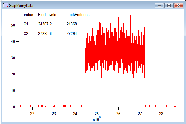

Here is an example (attached image) with the same parameters on a noisy data:
LookForIndex(myData,1, B=151)
FindLevels/B=151/Q/P/D=levelWave myData,1
