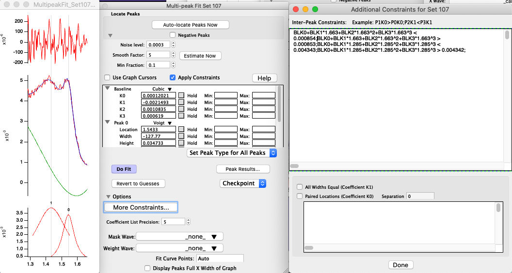

Hi all,
I am using the multi-peak fitting 2 package to fit a waveform with two Voigt function and a base function. I want to add a constraint that the base function needs to pass the endpoints. I couldn't find a place where I can put constraints consisting of linear combinations of baseline coefficients, so I just tried to put the following constraints in the "Inter peak constraints" textbox and it turns out it doesn't work...
So I am wondering whether I can achieve these constraints in the GUI interface? It is pretty handy and it would be great if I can avoid using function.
Another question is that is it possible to fix the Gaussian width in a Voigt function during the fitting?
Thanks,

I have indeed tested the textbox by using simpler constraints like P0K0 < P1K0 and it works. But whenever the constraint only includes parameters of one peak, it always does nothing. So I guess it can only work for constraints between peaks.
This cut is from a photoemission spectroscopy data( roughly density of states vs binding energy ), so in theory, I should use Shirley background instead of a cubic function. But the features that I am looking at are from the valence band so Shirley background may don't work in this case. So I am interested in whether a simple cubic function can mostly capture the background.

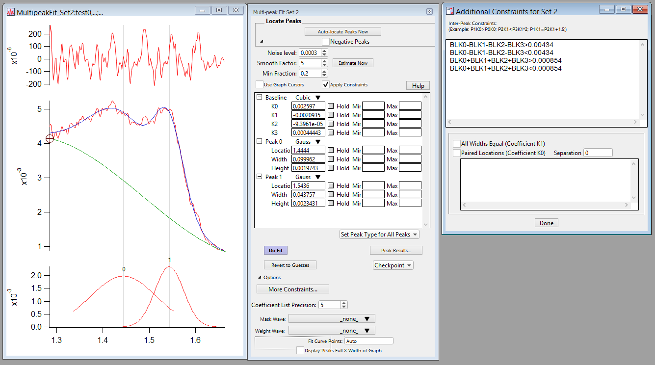

The constraints for the baseline are working OK, but it is very fiddly to set usable constraints. First you have to know that the real x values from your raw data have no meaning for the calculation of the cubic function. Here, the x values always get re-scaled to the range -1 (beginning of your fit range) to +1 (end of your fit range). Your constraints would thus need to look like this:
BLK0-BLK1-BLK2-BLK3>0.00434
BLK0-BLK1-BLK2-BLK3<0.00434
BLK0+BLK1+BLK2+BLK3>0.000854
BLK0+BLK1+BLK2+BLK3<0.000854
I got some reasonable result out of this (see attached file), but only with Gaussians, as the Voigt peaks would run off in all directions. Also, the constraint for the left edge does not get obeyed really. Maybe this one is overridden by the right constraint, idk.
To be honest, this approach is so far from reality that you would be better off to subtract a Shirley background before attempting to fit anything. I have a GUI for subtracting background and could create a project here on IgorExchange if there is interest.
