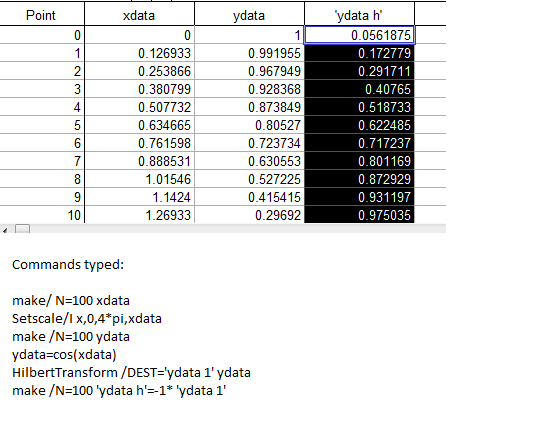

Hi
I have read the help topic that you mentioned and try to do the following.
Commands typed:
make/ N=100 xdata
Setscale/I x,0,4*pi,xdata
make /N=100 ydata
ydata=cos(xdata)
HilbertTransform /DEST='ydata 1' ydata
make /N=100 'ydata h'=-1* 'ydata 1'
Kindly refer to the picture attached for the values.
From what I know, the hilbert transform of a cosine function gives a sine function. However, the data 'ydata h' does not give me sine function; when xdata =0, 'ydata h' is not 0.
May I know how I can improve this?
Regards,
Eecheng

Hi jjweimer,
Thank you for the reply. However, the approach that you mentioned does not seem to work.
I guess it has smth to do with the amplitude scaling (from what I read from the help topic "Fourier Transform"). However, I do not know how I can scale the amplitude of the sine-wave.
Please enlighten me.
Regards,
EC

Thanks for the reply. I am aware that the command that you typed could give me an “accurate” cosine curve (hilbert transform of a sine curve). However, may I know why is it that I could not get an “accurate” cosine curve if I keyed the following command which I believe essentially does the same thing:
make/N=1000 ddd
Setscale/I x,0,2*pi, ddd
ddd=sin(x)
HilbertTransform/Dest=hddd ddd
setscale/I x,0,2*pi,hddd
By saying an “accurate” cosine curve, I mean the following. When ddd has the value of 0, hddd gets the value of 1. If I keyed in the command above, hddd is 0.988301 when ddd has the value of 0. This is why I am puzzled.
