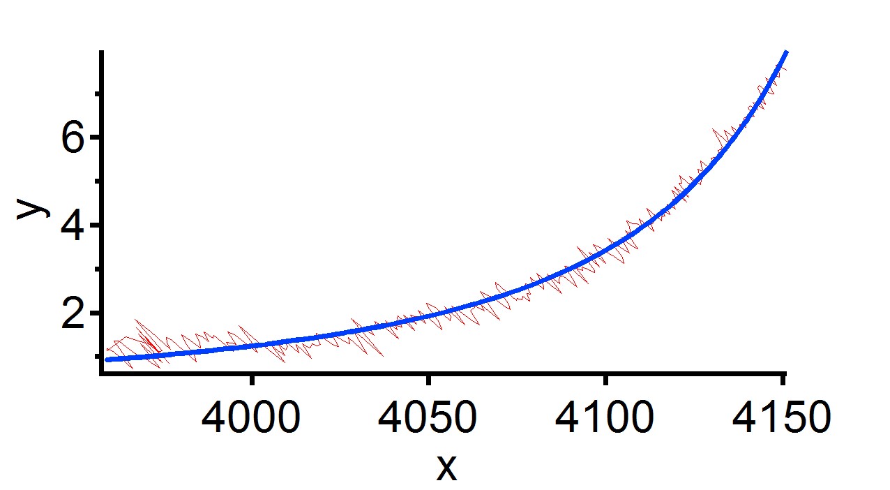

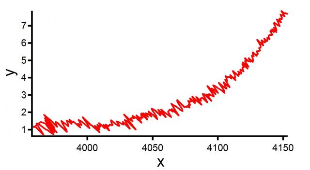

I have a set of data (see attached txt and image files) to fit with the following equation: y=a*(((4*(1-x/b+y/c))^-2)-0.25+x/b-y/c), where x and y are the independent and dependent variables, respectively. Coefficients are a, b, and c. As you see, y shows up on both sides of the equation. I tried to generate this equation in igor, however, it does not allow y to be on the right side of the equation. Do you have any idea how to apply this equation to fit the data? Thanks ahead.test.txt(3.97 KB)

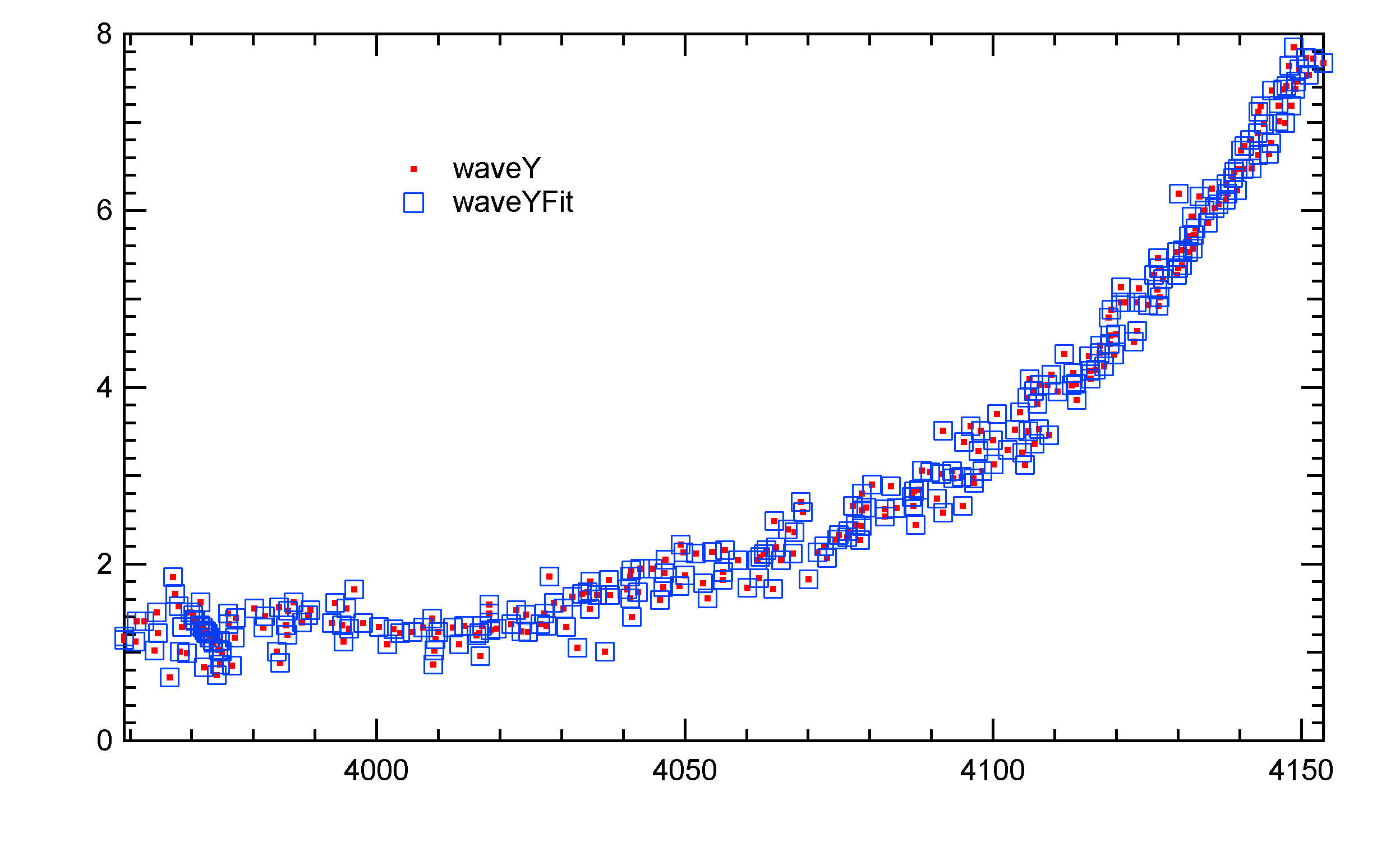

and got the following result (with attached graph)
•FitIt()
Fit converged properly
FitCoefs={-6.9236e-006,15941,6.9236e-006}
V_chisq= 3.61961e-024;V_npnts= 296;V_numNaNs= 0;V_numINFs= 0;
W_sigma={2.45e-16,9.78e-07,2.45e-16}
Coefficient values ± one standard deviation
a =-6.9236e-006 ± 2.45e-016
b =15941 ± 9.78e-007
c =6.9236e-006 ± 2.45e-016
However, I noticed that the 'a' and 'c' coefficients were very sensitive to initial guesses, so I would not trust their values. Notice the 'coincidental' agreement of their magnitudes, but with opposite signs. I don't know what this indicates about your model.

This is great! Our customers are learning about /ODR=3.
yuzhongbo wrote: Thank you, s.r.chinn, the procedure you wrote works well for fitting. The initial guess is important to obtain meaningful coefficients. I tried to vary the initial guesses and found various compositions of coefficients which give similar good looking fitting curve (see attached image). A big step forward so far. Thank you again. This really helps me out.
A result in which various different sets of coefficients can result in similarly good fits usually indicates "identifiability" problems. In fact, the fit that Steve Chinn got looks too good to be true; I'm not sure what coefficients you used to get the smooth line in your graph.
Identifiability problems means that two or more of the fit coefficients trade off in a way that makes it nearly impossible to solve for the values of both at once. They are correlated in a way that if you adjust one, you can find a value of the other that makes a fit that is nearly as good. Identifiability problems are generally accompanied by large estimated errors on the fit coefficients; that doesn't seem to be the case here. I don't know why.
You can diagnose identifiability problems after a successful fit by looking at the correlation matrix. To learn how to get it from an Igor fit execute this command on the command line:
DisplayHelpTopic "Correlation matrix"
It requires that you use the /M=2 flag with FuncFit. Adding /M=2 right after the FuncFit keyword in Steve's FitIt() function I made a correlation matrix for the fit. Here it is:
1 -0.578566 -1
-0.578566 1 0.578565
-1 0.578565 1
Note the off-diagonal values of -1. That indicates essentially perfect correlation between w[0] and w[2]. Looking at your equation, it doesn't appear that there is a true mathematical dependence, but it looks like within the domain of the data, there is little to distinguish a and c.
Unfortunately, this is not a problem with Igor's fitting routines. It is a mathematical problem that can only be solved by either figuring out how to get data that will distinguish those coefficients, or by simplifying your fit function.
This makes the function pretty useless for fitting because priting all those numbers in the history slows it down so much. But the result was quite instructive. Here is a little bit of the output:
Note that term1 is many orders of magnitude smaller than the rest of the numbers, and term2 is quite a bit smaller than term3, so most of the contribution to the output value comes from just term3. That means that there is little contribution to the result from coefficient b and in term3 the result is determined by a ration of a/c, so as long as a and c are adjusted to keep a/c constant, you will get almost the identical fit.
John Weeks wrote: It requires that you use the /M=2 flag with FuncFit. Adding /M=2 right after the FuncFit keyword in Steve's FitIt() function I made a correlation matrix for the fit. Here it is:

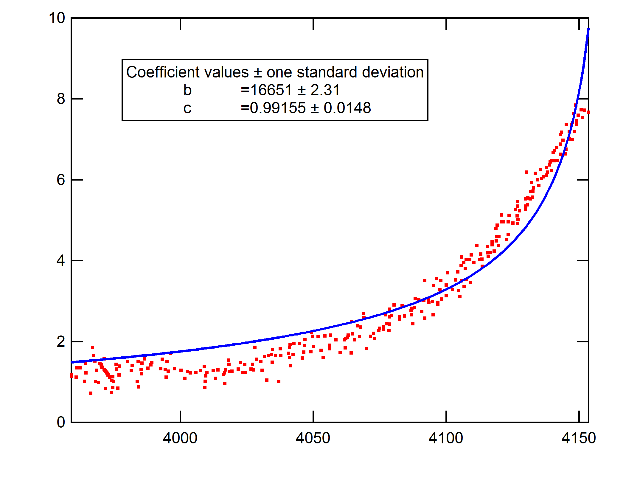

Function FitCurve(w,x) : FitFunc
Wave w
Variablex//CurveFitDialog/ These comments were created by the Curve Fitting dialog. Altering them will//CurveFitDialog/ make the function less convenient to work with in the Curve Fitting dialog.//CurveFitDialog/ Equation://CurveFitDialog/ f(x) = c*( 0.5/sqrt(1-4*x/b) + x/b -1 )//CurveFitDialog/ End of Equation//CurveFitDialog/ Independent Variables 1//CurveFitDialog/ x//CurveFitDialog/ Coefficients 2//CurveFitDialog/ w[0] = b//CurveFitDialog/ w[1] = creturn w[1]*(0.5/sqrt(1-4*(x/w[0])) + (x/w[0]) -1)End
The resulting explicit fit gives the following results and attached graph.
fit_waveY= fitcurve(w_coef,x)
w_coef={16651,0.99155}
V_chisq= 72.5424;V_npnts= 296;V_numNaNs= 0;V_numINFs= 0;
V_startRow= 0;V_endRow= 295;
W_sigma={2.31,0.0148}
b =16651 ± 2.31
c =0.99155 ± 0.0148
I would suggest that the original fitting model warrants re-examination.
