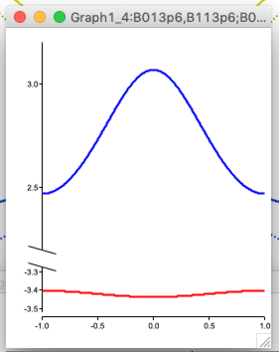

I'm preparing some graphs for publication and I cannot get them to appear less jagged. The blue curve in the attached image looks OK on paper but the red doesn't quite look smooth. These are waves with 501 calculated points. Here are things I've tried:
- Added more points to the curve (no visual change)
- Tried line, dots, circular markers..
- Made the waves double precision.
- Tried "smooth"- perhaps I could push more on this..
Any insight?
Thank you!
I recommend to save the graph instead as some vector graphics format => sharp at any zoom level, less size and easily editable after the fact. There are already so many publications out there with bloated or horribly compressed figures. Most likely you want to go for PDF, but SVG or EMF will do as well. Depends a bit on what the requirements of the journal are. Also, copypasting a graph directly from Igor into Word will paste as vector graphics into the document (at least on windows, don't know about mac).

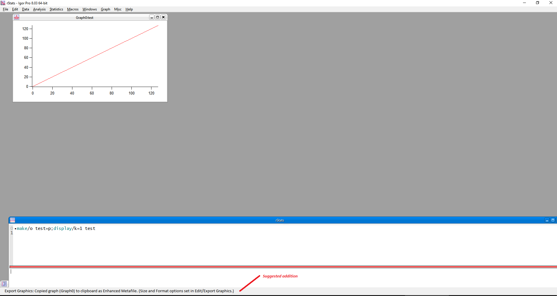

I wonder if a convenient mechanism might be through the bottom ribbon (not sure that's the best name for it, but see attached). I can't recall whether this ribbon existed before Igor 8. It is already very useful because it shows built-in and user-defined function templates. When the user is interacting with the GUI (and thus not typing, so no template would need to be shown), Igor could put messages about the last thing that has been done.
One of Igor's most appealing qualities (compared to other GUI-based analysis packages) is how transparent many of its innerworkings are -- chiefly because so many GUI interfaces print what they do to the command line as they do it.
But not all of them do -- Export Graphics is just one example. Maybe making more use of this ribbon can help make Igor even more transparent.
Attachment: example of what the bottom ribbon could say to inform users what just happened and how they can change the behavior.
