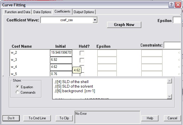

This is my problem. For some funny reason I cannot scroll the list of fitting coefficients (like in the picture).
Thus, I was thinking that resizing of the window can help.

Seeing the screen shot, I see that your Curve Fitting dialog has gotten into a pathological state in which the dialog is too small for its contents. I don't know how it got that way.
Try this-
Find your Igor preferences folder. You will have to start from My Computer, open your main hard drive (usually C) and navigate to Documents and Settings\Application Data\WaveMetrics. You should find a folder Igor Pro 5. Drag that folder to someplace else, the desktop would be fine. Now re-start Igor.
If that solves the problem, tell me about by email to support@wavemetrics.com. Please include a zipped copy of the Igor Pro 5 folder that you dragged to the desktop.
Also- what exact version of Igor are you using? The last of Igor Pro 5 was 5.05a.
