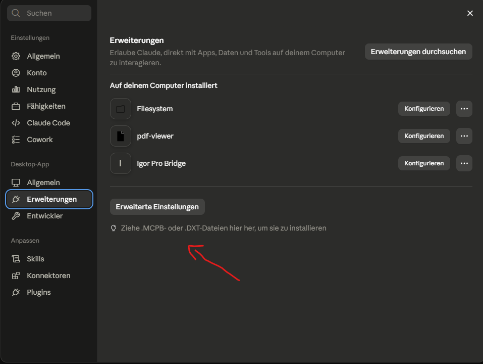

Michael Huth
maybe this is interesting for someone, I used Claude to create a basic MCP server for Igor Pro 9+. It uses the Windows COM Automation interface.
There is currently a PR here: https://github.com/AllenInstitute/MIES/pull/2754
This will probably be obsolete as soon an official MCP server exists.
The PR includes a mcpb file, some documentation as rst file and I also included my session notes. The MCP server is based on python.
Here are some quick steps to get it working on the example of Claude:
The Windows COM Automation interface works only when the Claude Client and Igor Pro runs elevated.
- Open an elevated shell and install python (if not already present) with "winget install python"
- install required packages: pip install mcp pywin32
- run another post install command for pywin32: python -m pywin32_postinstall -install
- start Claude Desktop Client elevated and pull the igor-pro-bridge-1.22.0.mcpb by drag'n drop in as new extension
Lets say you have some folder or repository with your Igor Pro code or some experiment file.
Tell Claude to include this folder in this session with write access. It should prompt and ask.
Tell Claude also to include the Igor Pro folder itself, which allows the client to read the Igor help files. It should prompt and ask.
Make sure no Igor Pro instance is running. Tell Claude to open Igor Pro. It will ask you for the Path to Igor64.exe and then open it. (Thus, Igor Pro will also run elevated)
The Claude Client is then able to change procedure files on disk in your projects folder, reload procedures, compile and run functions, readback history output, readback the current environment within Igor Pro etc. It can not write code to the integrated procedure window. It is able to load experiment files.
I put my session notes as markdown file in this PR as well. For a start it is most likely helpful to put that file also in your folder and tell Claude to read and use it as note file for your session.
Also there is a MIES_ClaudeHelper.ipf file in the PR with one helper function for Claude. (An AfterCompileHook)
Include that file as well in your Igor Pro environment or copy the function over. It is gated by a required
#define IGOR_PRO_BRIDGE
