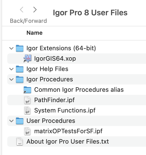

I have two custom procedures, PathFinder.ipf and System Functions.ipf, that I want Igor 8 to load every time it starts up. There's also an alias to a folder containing more procedures. I have put these three items in the Mac folder
/Users/amtravco/Documents/WaveMetrics/Igor Pro 8 User Files/Igor Procedures
I attach a screenshot of my Igor Pro 8 Files folder, to which I navigated by using Help/Show Igor Pro User Files.
However, the procedure files don't load. This worked fine until I updated to a new M1 Mac. Somewhat oddly, the files used to be in "User Procedures", which I have read don't load by default, but it always worked this way.
Any suggestions on how to get these procedures to load?

I clicked on the link after "Path is" and it took me to the same folder as in my screenshot.

Try renaming "Igor Pro 8 User Files" as "Igor Pro 8 User Files - Old". Then restart Igor. It should create a new "Igor Pro 8 User Files" folder. Move your files from "Igor Pro 8 User Files - Old" to "Igor Pro 8 User Files". Then restart Igor again.
Check Windows->Procedure Windows to see if the files were loaded.

I tried the scheme of renaming Igor Pro 8 User Files and letting Igor recreate the folder. This worked. Not sure what was going on, but thanks for the help.
