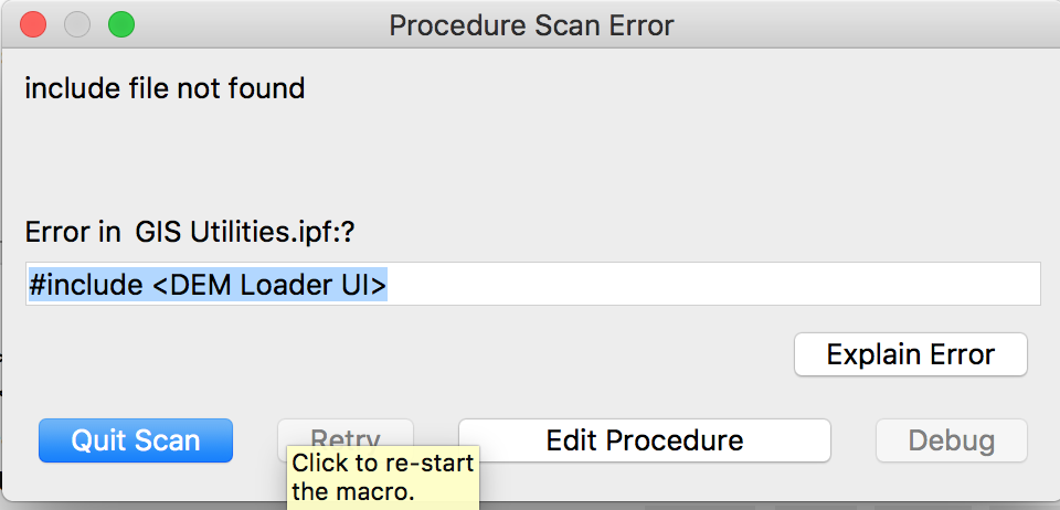

Hi,
I use an IGOR PRO 7 version. I tried to load the GIS utilities, but jump out a error window. I tracked the issue online, and did the activation. Nothing happened to better case after all these.
Does anyone have the same problem as I do?
Looking forward to your reply.

I get the same error on my installation.
I am guessing the file was accidentally omitted. I looked in the folder WaveMetrics Procedures>Data Manipulation where the GIS Utilities help.ihf is and there is no GIS Utilities help.ipf file.

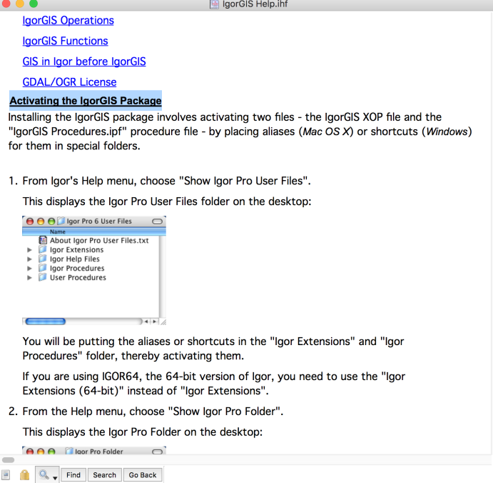

The original post references two different things.
The thumbnail showing the error dialog references the GIS Utilties package. GIS Utilties is an old package consisting of the GISLoadWave XOP, the "GIS Utilities.ipf" procedure file, and the "GIS Utilities.ihf" help file. It looks like, in Igor7, only the help file is shipped and I suspect that was unintended.
The attachment ("Screen Shot 2017-03-25") in the original post refers to the IgorGIS package. This is a newer package that consists of the IgorGIS XOP, the "IgorGIS Procedures.ipf" procedure file, and the "IgorGIS Help.ihf" help file. To read about the IgorGIS Package, execute:
DisplayHelpTopic "IgorGIS Package"
That topic explains how to activate the IgorGIS package. Follow the instructions carefully and make sure to activate the 64-bit version of the XOP for Igor64 and the 32-bit version for Igor32.
Included in the "IgorGIS Help.ihf" file is a topic, "GIS in Igor before IgorGIS", which says, referring to the old "GIS Utilities" package "These older tools have been largely removed for Igor 7". I recall vaguely that we discussed removing the "GIS Utilities" package from Igor7 and decided that virtually no one was using it.
NOTE: The IgorGIS package is powerful but has a learning curve. It is essential that you do the guided tour in the "IgorGIS Help.ihf" help file. You will also probably need some understanding of GIS data formats and techniques.

Hi Jim,
I downloaded your attached file and put it in the folder, finding it works for the first error now. Thanks.
After I click "install GIS utilities", it comes out a new error. See attached screenshot,
Peter

Andy is one of the more helpful users of Igor Pro here on IgorExchange. He's not responsible for how Igor Pro is built or documented; we are.
A video explaining how to create shortcuts or aliases to files on Windows or Macintosh isn't likely to be made anytime soon, but I can tell you that the simplest mistake to make (and I've just done this) is to put the alias to the XOP in the wrong folder, because there are 3 ways to get it wrong and only 1 way to get it right.
Basically, if you run Igor 64-bit, make a shortcut or alias to XOPs whose names end with "64", in this case "IgorGIS64.xop".
Then move that shortcut or alias to either Igor Extensions (64-bit) folder.
That is, one of Igor Pro Folder/Igor Extensions (64-bit) or Igor Pro 7 User Files/Igor Extensions (64-bit).
If you use Igor 32-bit, then create a shortcut/alias to the XOP without 64 in it, and move it to a folder without (64-bit) in it.
And don't forget to move a shortcut or alias to the IgorGIS Procedures.ipf into one of the Igor Procedures folders in either case.
Then restart Igor; that's important, too.

My first post in this thread was not quite as clear as I intended.
The "GIS Utilities" package is obsolete. You should use the IgorGIS package instead (more on this below).
We neglected to remove parts of the old "GIS Utilities" package from Igor7 and thus left the Data->Load Waves->Packages->Install GIS Utilities menu item in place. This menu item does not work and should have been removed. Sorry for the confusion. We will remove it for the next release.

The obsolete GIS utilities had been removed in Igor 7, except I missed the help file and the Data>Load Waves>Packages>Install GIS Utilities menu item definition. These have both been removed from IP 7.03B01, so there should no longer be any traces of the old GIS utilities that ship with Igor 6.
