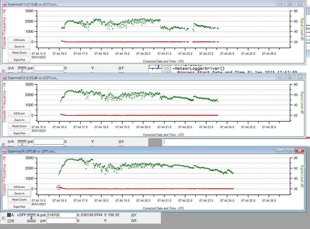

It was my easy (crude) way of zooming , selecting an ancilliary plot or process based on the graph I was using. Here I have clicked on a button to Zoom-in all three plots to the time on the lower plot cursor. The triple plot button displays all three on one plot.
Looks like I will need to look at this again .....

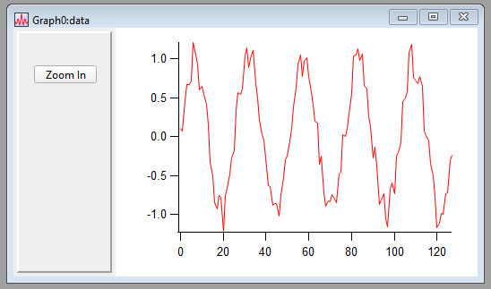

Mike, you might prefer to use ControlBar /L, instead, which would make room for your controls on the left.
But WaveMetrics *does* recommend you use a panel subwindow, like this:
PauseUpdate; Silent 1 // building window...
Display /W=(41.25,41.75,429.75,250.25) data
ControlBar/L 114
NewPanel/W=(0.2,0.2,0.8,0.8)/FG=(FL,GT,GL,FB)/HOST=#
Button zoomIn,pos={23.00,42.00},size={70.00,20.00},title="Zoom In"
RenameWindow #,PLeft
SetActiveSubwindow ##
EndMacro
