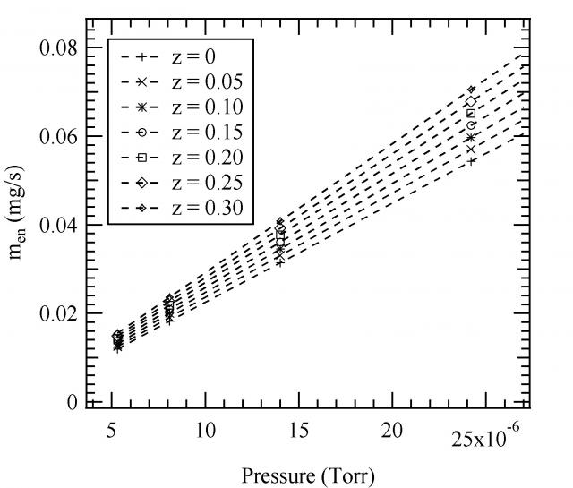

I'm new to Igor and I'm having a hard time trying to make the x-axis label on my plot to display engineering unit like 1E-6, 5 E-5, 1E-4, etc. I have looked at the "ticks and grids" tab and tried to switch between "engineering" and "scientific" but it cant get it to display how I wanted. It always shows 100x10^-6 etc... Also the x-y ticks are overlapping at the corner with my manual range setting, is there anyway to make it not overlap? I have attached an example here.
Thank you

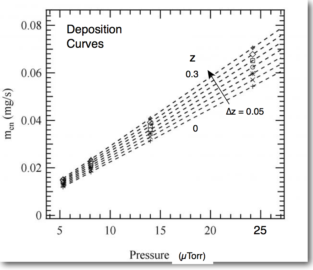

[quote=oipunx]... Also the x-y ticks are overlapping at the corner with my manual range setting, is there anyway to make it not overlap?[/quote]
You will need to change one or all of three things to get this to work ...
* Auto/Manual Ticks ... number of ticks
* Axis ... axis standoff UNCHECKED
* Ticks & Grids ... outside rather than inside
Here's my cleaned up presentation your graph.
EDIT: On a less biting note ...
The intent of a graph is to show the data as clearly as possible. My concern is, your graph hides the data behind too many adornments. You can get to the above far clearer graph by simple steps such as: eliminating the legend in favor of a figure title + annotations and using unit scaling on your x-axis.
Apologies otherwise ... my comments are not directed at you as a personal attack, rather out of general frustration whenever I see such bad habits.
