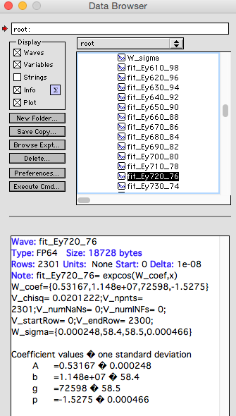

I fitted some wave by using new fit function. f(x)=Acos(bx+p)exp(-gx)
The new fit function have four coefficients of A, b, g and p. (I attached screenshot)
I fitted 20 waves.
Finally, I want to make new wave consists of fitted coefficient.
How can I return the fitted coefficient value?
One more question..
As I attached screenshot,
The Data browser can't show +- sign, it shows diamond and question mark.
How can I fix it?
I use Igor Pro 6.35A5 on Yosemite and main language of OS X is Korean.
Thank you very much.
2014-10-24 오후 8.03.24.png (62.47 KB)
