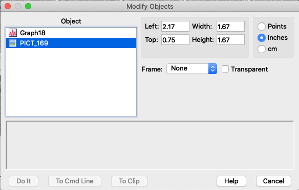

@chozo Sorry, but how do I "Modify Graph"? I know how to open the "Modify Object" window (see attached; PICT_169 is the image I want to rotate), but I am not sure how to proceed next.
(Actually PICT_169 could no show itself in the Modify Object list until I copied it from the Draw Mode and pasted it in the Operate Mode.)

Page layouts are complicated. Based on the screenshot you attached earlier, it appears that you have inserted your picture into the layout layer. As far as I know, it's not possible to rotate objects in the layout layer.
However, if you insert the picture into the drawing layer, it is possible to rotate the picture.

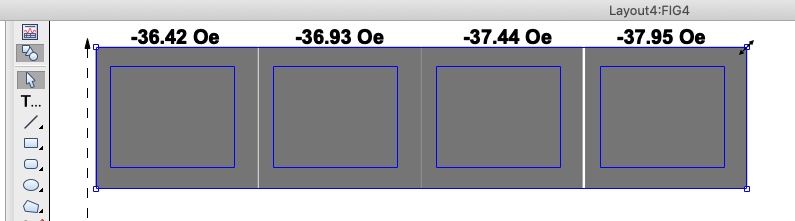

@aclight When I drag the double arrow (see attached), I can only stretch the image. How do I rotate it?
July 12, 2022 at 08:06 am - Permalink
That's the resize double arrow, not the rotate arrow. Previously I said "...a double arrow that indicates rotate mode (arrow heads pointing to the upper-right and lower-left)". That's the case for the bottom right point of the image, but not the top right point you are using. You want the cursor that is perpendicular to the line between the center of the object and the corner of the object you have selected.
July 12, 2022 at 08:09 am - Permalink
In reply to That's the resize double… by aclight
@aclight Great! I never realized that, if I move the cursor just a little away from the bottom right corner, it will change from an upper-left and lower-right double arrow to an upper-right and lower-left one! That's new to me. Thank you.
July 12, 2022 at 08:24 am - Permalink
All four corners of a draw object have rotation handles, but as you have discovered, the hit rectangle for rotation is a bit outside the resize handle. The little square you see at the corner of a selected draw object is the resize handle, and the rotate "handle" is outside of that square. That region has no visible manifestation, unfortunately, except for the change in the cursor.
