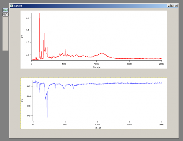

i have 3 Waves and they are "Time", "CV1" and "CV2", and then i maked a panel with 2 graphics (each graphic in its own subwindow), plane#graphic1 displays CV1 vs Time, and plane#graphic2 displays CV2 vs Time.
Here is my question, how can i make these 2 Graphics synchronized? I mean, the axis for x value could be changed together when i use e.g. "Expand" or "Autoscale Axis".
I thought the best way to solve this is with the window hook function. I tried to detect event "Modified"(case 8 ) in a subwindow and then use "SetAxis" to change the other graphic, but it doesn't work. The Manual shows me this event(Modified) sents to graph and notebook windows only, if it means "modified" will not work for a graphic-subwindow on a panel ?
Then i tired to use the "Menu Detection", e.g. detect the "Expand" in Menu "GraphMarquee", i thought the MenuName is "GraphMarquee" and MenuItem is "Expand", but it returns nothing.
I thought i may have something wrong with my Strategy or something else, so any suggestion or idea will be very appreciated.
Sorry for my English.
Have a Nice Day!

But i stll want to ask, is it possible to do this on a panel with subwindows?

KurtB wrote: There is probably a much better way of doing it that this, but here is some demonstration code of something that nearly works:
Hi KurtB, thank you so much for this excellnet and awesome idea. It is very helpful, i will try and see if i can avoid the "misunderstand" context.
