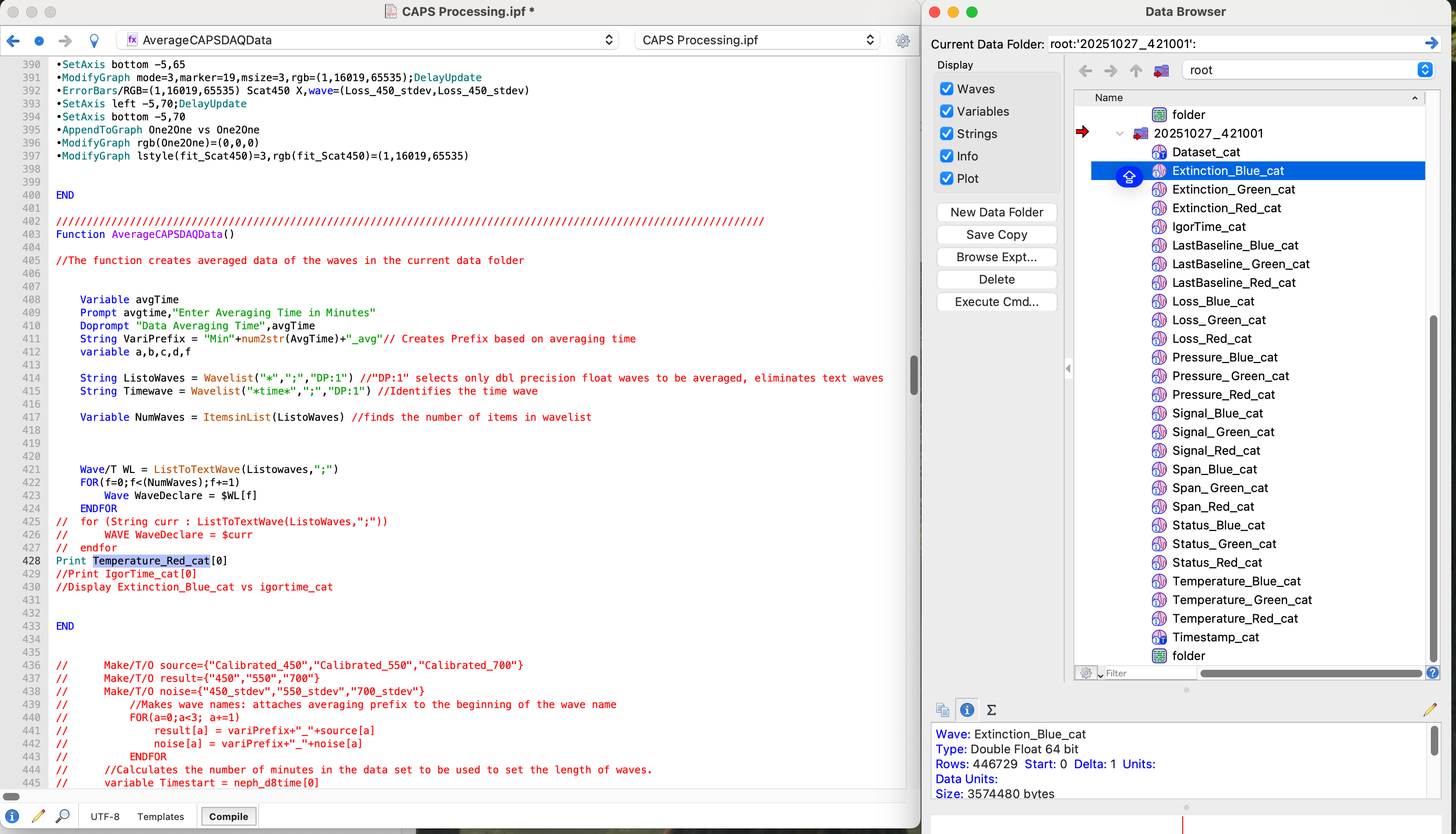

Hi All--

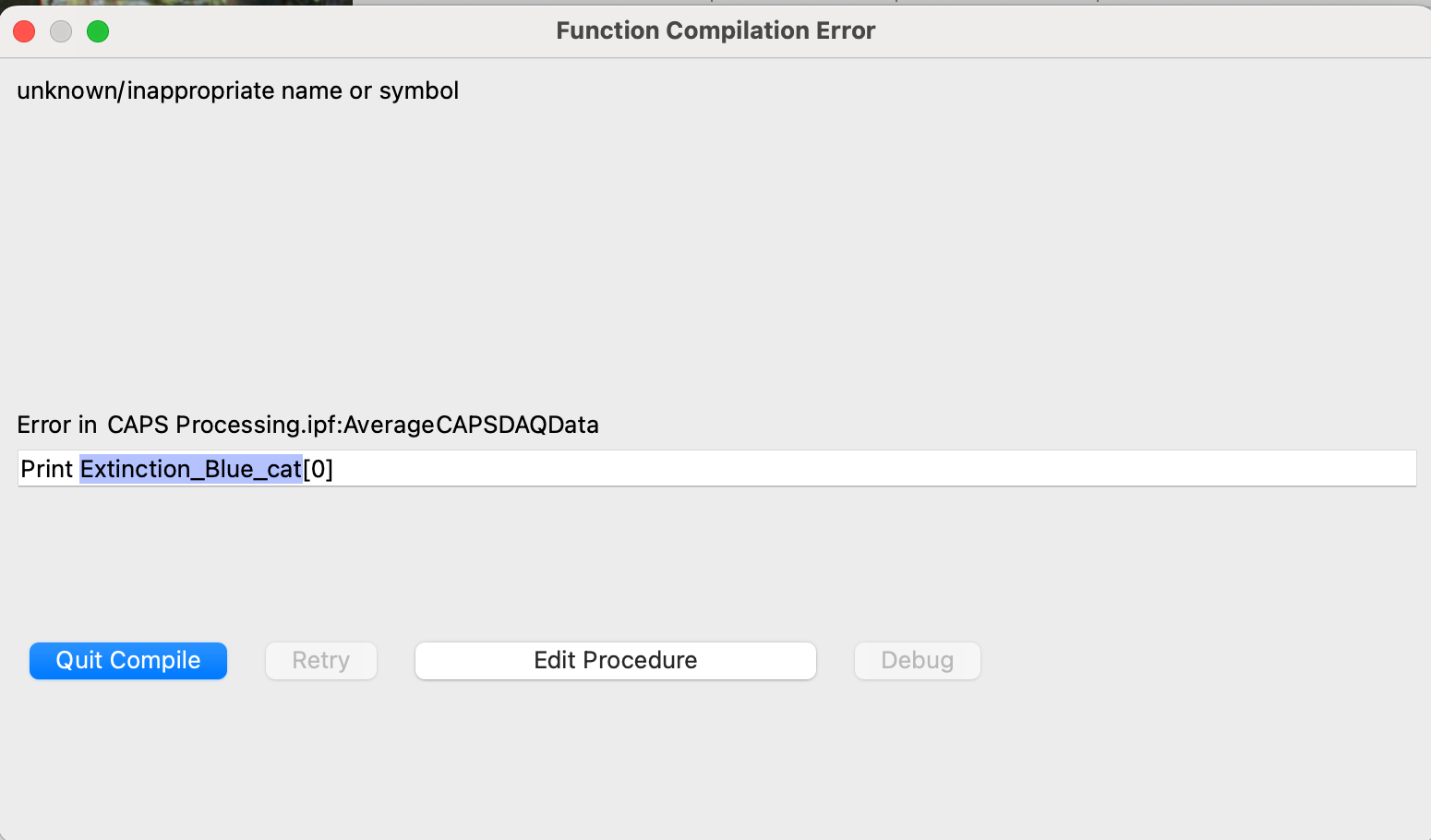

     This code doesn't compile. It fails at the first print statement. See the attached file. Again I'm trying to declare all of the waves in the current folder so I don't have to list/declare them individually in addition to making it versatile. This way it can be used to create averages for different wave names. It also doesn't compile if I switch the FOR loops. My guess is that I'm trying to use waves (Extinction_Blue_cat, IgorTime_Cat) before they are declared. Any help is greatly appreciated. Thanks.

Function AverageCAPSDAQData()
//The function creates averaged data of the waves in the current data folder
    Variable avgTime
    Prompt avgtime,"Enter Averaging Time in Minutes"
    Doprompt "Data Averaging Time",avgTime
    String VariPrefix = "Min"+num2str(AvgTime)+"_avg"// Creates Prefix based on averaging time
    variable a,b,c,d,f
    String ListoWaves = Wavelist("*",";","DP:1") //"DP:1" selects only dbl precision float waves to be averaged, eliminates text waves
    String Timewave = Wavelist("*time*",";","DP:1") //Identifies the time wave
//  Print ListoWaves
//  Print Timewave
    Variable NumWaves = ItemsinList(ListoWaves) //finds the number of items in wavelist
//  Print Numwaves
//  Wave/T WL = ListToTextWave(Listowaves,";")
//  FOR(f=0;f<(NumWaves);f+=1)
//      Wave WaveDeclare = $WL[f]
//  ENDFOR
    for (String curr : ListToTextWave(ListoWaves,";"))
        WAVE WaveDeclare = $curr
Print Extinction_Blue_cat[0]
Print IgorTime_cat[0]
Display Extinction_Blue_cat vs igortime_cat
END

The declaration
associates the local wave name "WaveDeclare" with the wave whose name is in the string variable. Therefore it doesn't make sense to repeat such a declaration in a loop: at the end WaveDeclare will be associated with the last wave in the list. You need different local names for different waves.
You may try a function like:
function/wave name2wave(string name)
wave/z w=$name
if (!WaveExists(w))
   abort "the wave "+name+" does not exist"
return w
and then :
wave Extinction_Blue_cat=name2wave("Extinction_Blue_cat")
wave IgorTime_cat=name2wave("IgorTime_cat")
print Extinction_Blue_cat[0]
etc.
but the following will work too (without local name):
print name2wave("Extinction_Blue_cat")[0]  // will quit here if blue cats don't exist

    //Wave/Wave  WL = ListToWaveRefWave(Listowaves,0) //Declares all of the waves in the selected folder
                                                    //so they can used as if they were declared by name
//  I want to replace this with
    Wave IgorTime_cat
    Wave Extinction_Blue_cat,Extinction_green_cat,Extinction_red_cat
    Wave LastBaseLine_Blue_cat,LastBaseLine_green_cat,LastBaseLine_red_cat
    Wave Loss_Blue_cat,Loss_green_cat,Loss_Red_cat
    Wave Pressure_Blue_Cat,Pressure_Green_Cat,Pressure_Red_Cat
    Wave Signal_Blue_cat,Signal_Green_cat,Signal_Red_cat
//With something like this
    For(a=0;a<numwaves;a+=1)
        Wave Listowaves[a]
    ENDFOR
// So I can do something like this:
    Display Extinction_Blue_cat vs Igortime_cat
    Appendtograph Extinction_Green_cat vs Igortime_cat
END
Thanks for the help
ssmith911

Pawel et al.--
     Perhaps you are right. I may be making this more difficult that it needs to be. On top of that my attempts at explaining what I'm trying to accomplish is muddying the water for you guys...I apologize for that. Allow me to try one more time to be more specific:
When declaring waves for future use in a function if there are only 6 or 7 waves then this is fine:
Wave IgorTime_cat
Now if there are 30 waves, or more, that need to be declared and may change depending on the instrument the amount of typing becomes excessive not to mention the possible typos that would occur (LOL). So what I'm trying to code is a generic way to declare all of the waves in the current datafolder, so they can be used, by the actual wavename. This way I can move this snippet of code to other functions for the wave declaration part of the new function. Now there may not be an easy way to do this. If not thats fine. I'll just have to create specific wave declarations for each function I create. I am using this as a way to learn how to code in Igor and make the code a littIe simplier in the future. I hope this clears it up. Thank you so much for your patience and help.
OK. You cannot hard-code a generic function to define a wave reference to any random wave in any random data folder exactly by the actual name of the (randomly) chosen wave. (*) Since you cannot do what you want for one wave, you cannot do what you want for a set of waves.
What you can do is assign a specifically pre-named wave reference to a string that is a (randomly chosen) wave name. So,
WAVE my_named_wave = my_named_wave // impossible for automation to hard-code
WAVE currwaveref = $currentwavename // identically possible to code and run automatically
Hope this finally clears up your question.
