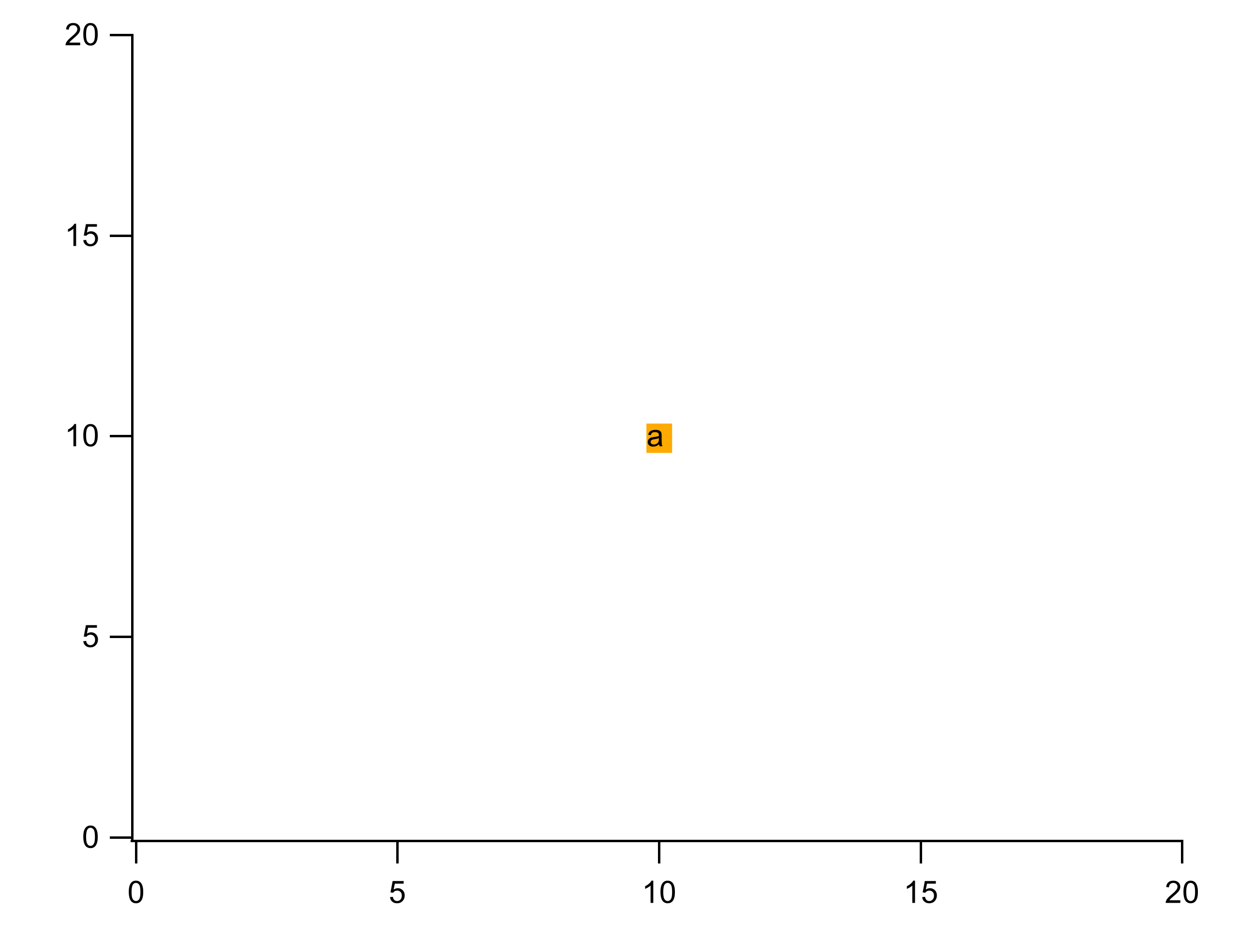

I've looked into Tex but that seems to be difficult in getting colored. How about unicode then?
TextBox/C/N=text0/F=0 "\\[0\\K(65535,43690,0)\\[1▉\\]0\\K(0,0,0)\\X1a"The box is U+2589 found on http://www.alanwood.net/unicode/block_elements.html.
July 25, 2018 at 02:59 am - Permalink
In reply to I've looked into Tex but… by thomas_braun
Thanks, Thomas. That is an excellent suggestion. On an initial test with a multi-character text string, it appears that some fine tweaking may be required, possibly with restriction to a mono-spaced text font and/or the unicode block element description (e.g. U+2588). There are presently problems with text non-overlap and high-lighting gaps.

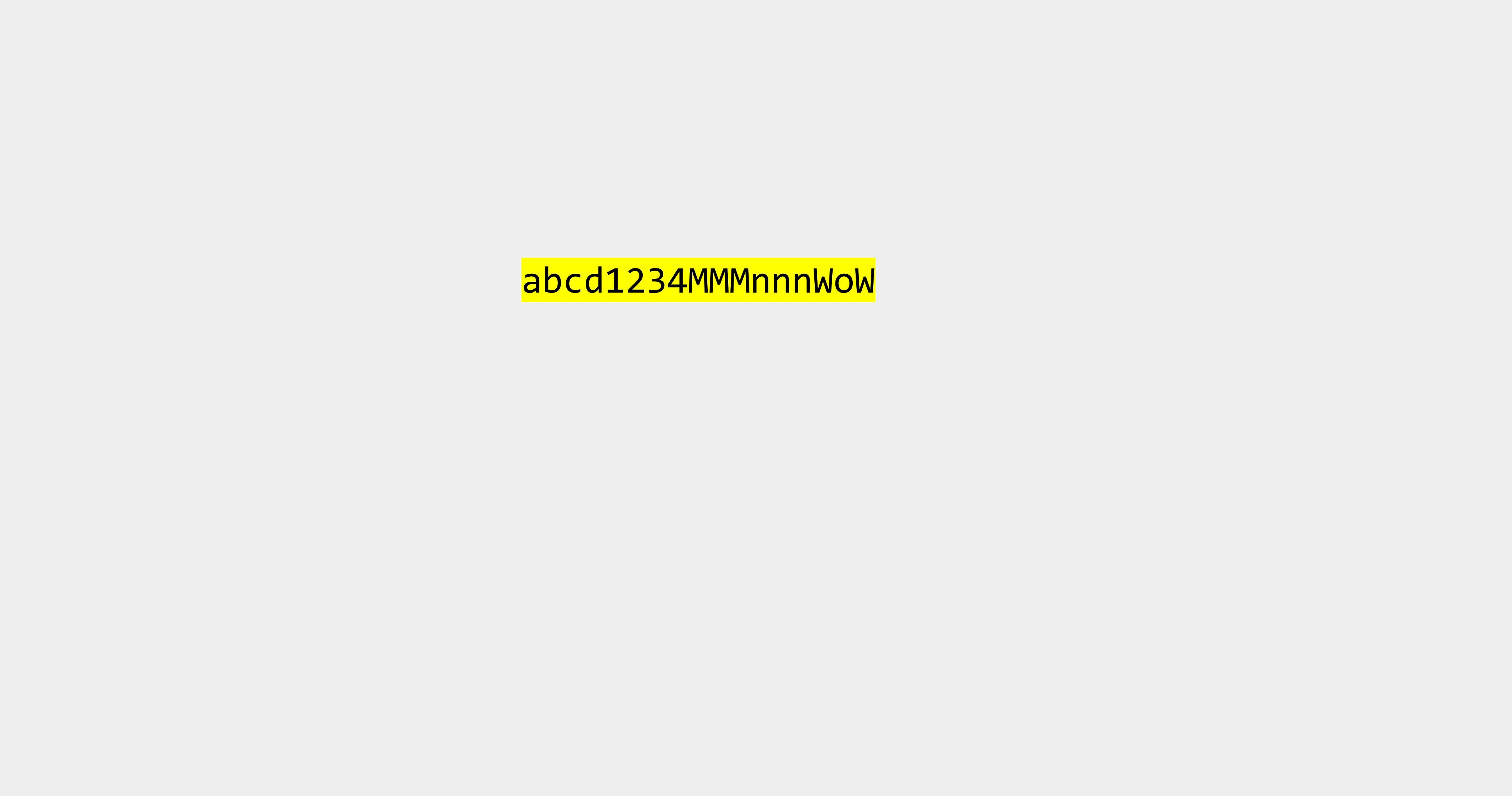

Addendum:
TextBox/C/N=text0/F=0 "\\F'Consolas'\\[0\\K(65535,65535,0)\\[1█████████████████\\]0\\K(0,0,0)\\X1abcd1234MMMnnnWoW"This uses the full-block U+2588, with mono-spaced font. The end result looks good, but the process is labor intensive.
Addendum 2 (an actual example of manual post-editing an existing Textbox):
"Modify Annotation" GUI entry:
Output Optical Energy = \[0\K(65535,65535,0)\[1█████\K(0,0,0)\X1\{string1}\{string1} is a dynamic global string variable with known 5-character numeric width. See the snipped picture of the actual graph textbox portion attached below
July 25, 2018 at 03:50 am - Permalink
