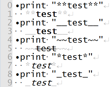

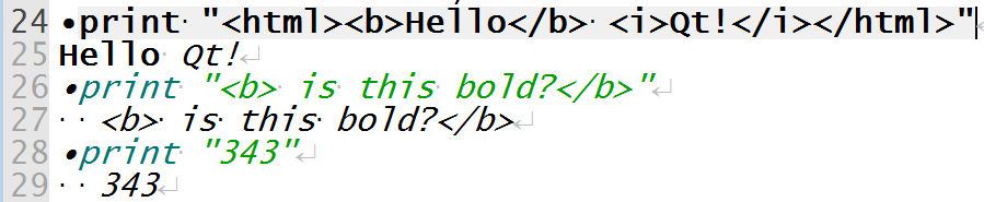

I played around a bit to see whether this is practical to implement using HTML and I don't think it is. I've attached a screenshot (HistoryStyled.png).
Note that line 25 is displayed correctly, with Hello in bold and Qt! in italics. But then note that lines 26-29 are also in italics. That's not right--they should all be in plain text.
I don't think this editor we're using is designed to mix plain and HTML text like this.
The easiest way to implement this would be similar to a syntax highlighter, which doesn't actually change the text itself, it just changes the color or other characteristics of the text based on certain rules. I've done a quick sample implementation of this using a syntax based on Markdown. That's also attached below (HistoryStyled2.png). Note that, when printed, the formatter characters (in this case, *, _, and ~) are also printed, though I'm printing them in a lighter color to make them fade into the background some.

HTML has the raw html source code (with all of it's ugly <xyz>...</xyz> tags), but the rendered version doesn't show the tags, just the rendered version. For example:
Raw:
<html><b>bold</b> not bold</html>
Rendered:
bold not bold
With a syntax highlighter, the text itself doesn't change, just how its displayed. With the simple test I put together, that's:
Raw:
**bold** not bold
"Rendered":
**bold** not bold
With the implementation I did in the example picture, the stars would be light grey, not regular black, but I can't set the color here. Note that the stars are in both the raw and rendered versions.
It's hackish but relatively easy to implement. But I'm not sure that the final result looks good enough to be worth implementing.
