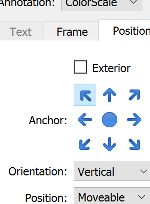

- Have 9 check boxes / buttons to select the anchor, positioned in a way which immediately shows their effect (see attached sketch) instead of the drop-down list.
Something like this?
One concern with this approach is that it makes it more difficult to use the dialog from the keyboard, as this adds 8 additional controls to tab through.

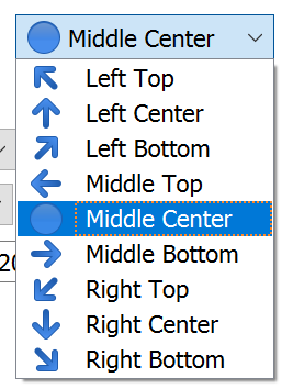

I do agree that it takes a lot of thought to correctly pick an anchor mode. An alternative to this button grid would be to put the same icons in the popup menu next to the corresponding items, like this:
This is much easier to implement in the several places where this popup is used.

The anchor point selection looks great! I see the point with the increased difficulty for keyboard-only manipulation. Does Qt allow to highlight the whole 9-point selector with one tab press? Then I could image tabbing only once and then selecting the anchor point with the numpad or number keys as a fast operation.
I didn't know the popup was used in several places. Is it possible to have both? I would really be in favor of the 9-point selector inside the Annotation panel. Then the pupup with the symbols included could be used in other places.

That should be possible but is a lot more work. I'm also not sure what the best way would be to make it obvious to a user that pressing a number key will activate one of the buttons. Probably putting the number in the button itself, but it may be challenging to get that to look good and not be too large.
It's currently in the Draw Text, Add Annotation, and Text Markers dialog. The Draw Text dialog is already kind of large, so it might be hard to use the 9 button control there.
