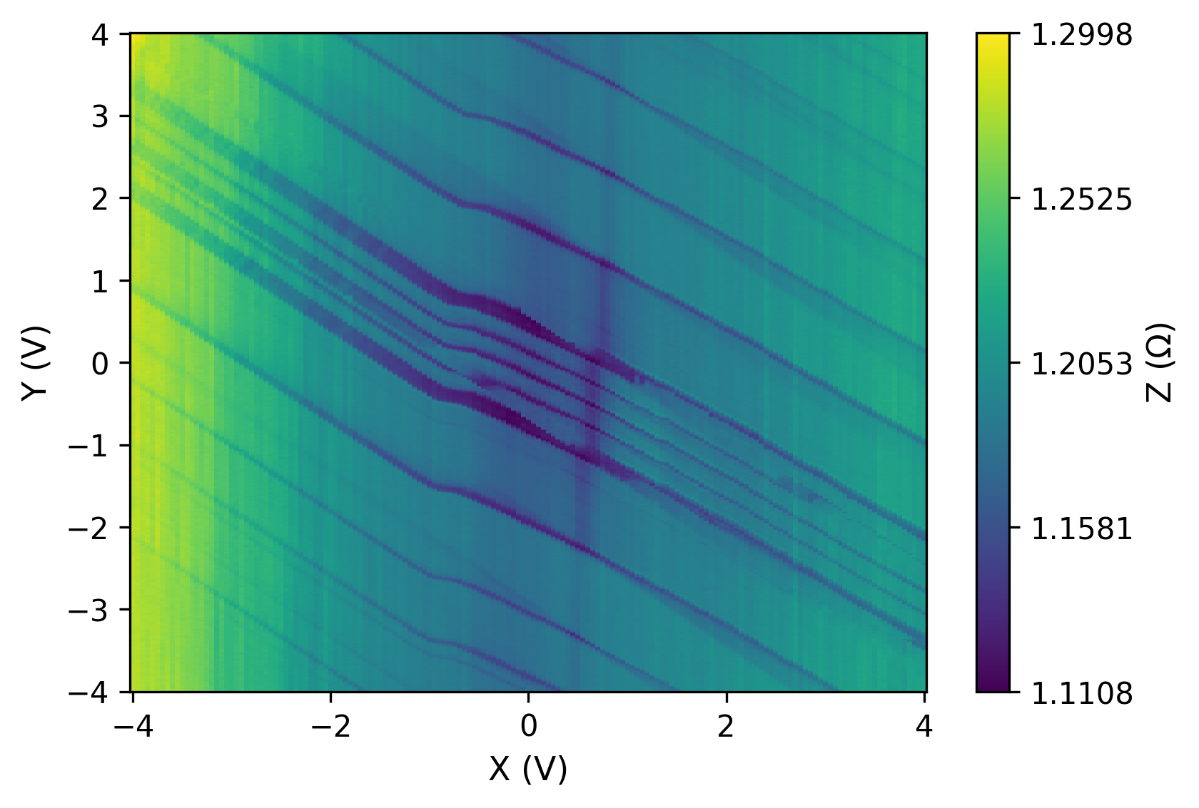

The source files and the desired plots made by python matplotlib is showed in png files. Figure 1 shows the plot for Z(X,Y), where X and Y are in gridded topology but not exactly spaced.

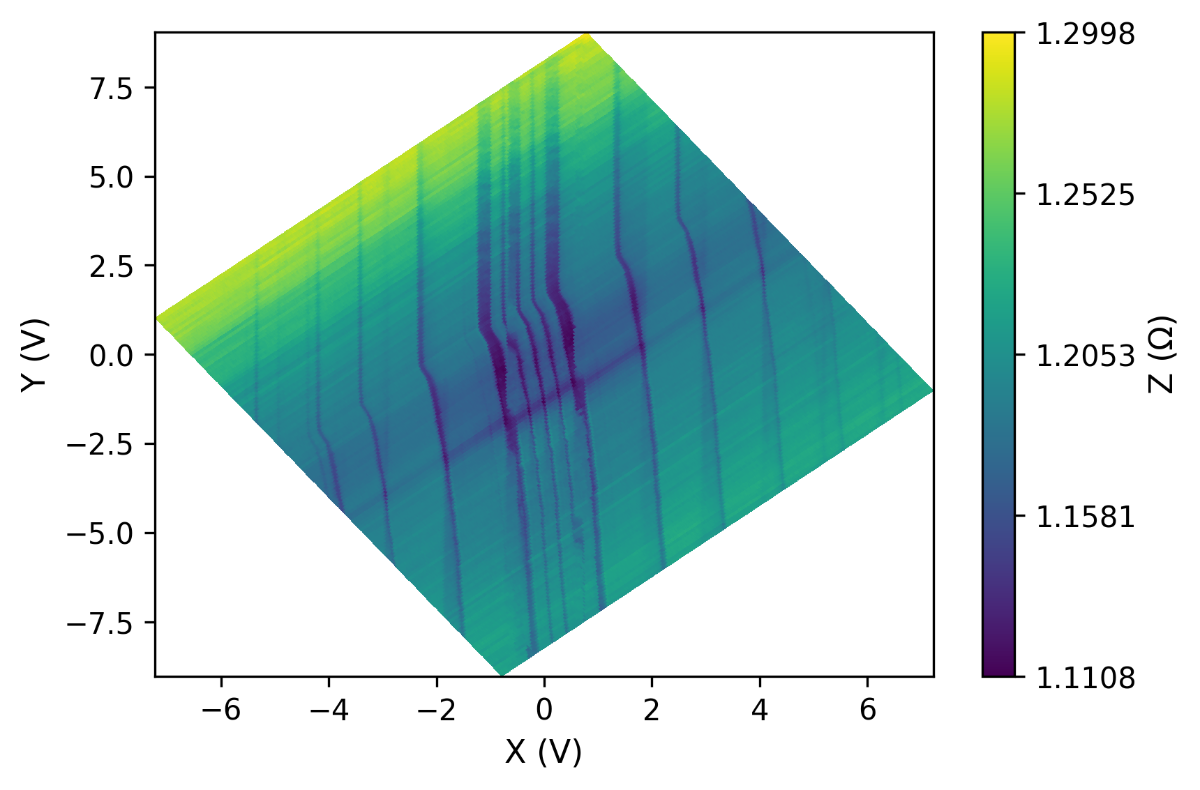

Figure 2 shows a coordinate transformation from (X,Y) -> (x1,y1), and then Z(x1,y1) was plotted. In matplotlib, this plot can be generated by the same method with figure 1 by a simple command 'pcolor(x1,y1,Z)'. While in igor pro, it can only be visualized in gizmo surface plot with parametric data input.
