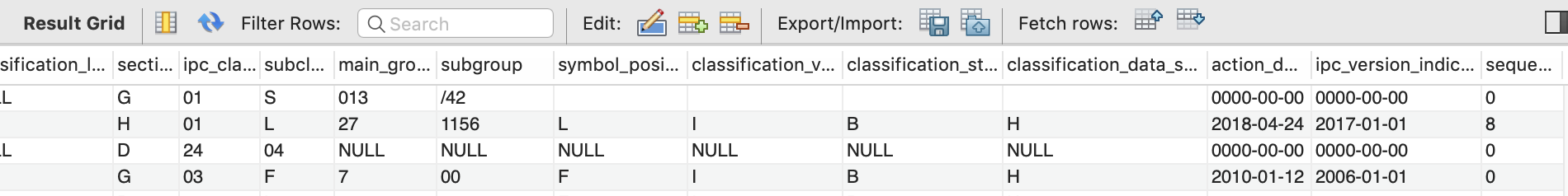

However if I execute this in MySQLworkbench.
load data infile '/Volumes/Patents/MySQL/xaa.tsv' INTO TABLE patents.ipcr FIELDS TERMINATED BY '\t' IGNORE 1 LINES;
It works as expected as seen by the data table in the image.  On the right hand side you see 0000-00-00 entered into the action date column.  This is correct a represents a missing value. This is the correct and desired behavior.

Correct Data as imported via MySQLworkbench
hegedus
I think I might have found the solution.  In MySQLworkbench there was an option set:
set sql_mode='';
I tested this without this setting and it appears to give the same date error code on loading.
