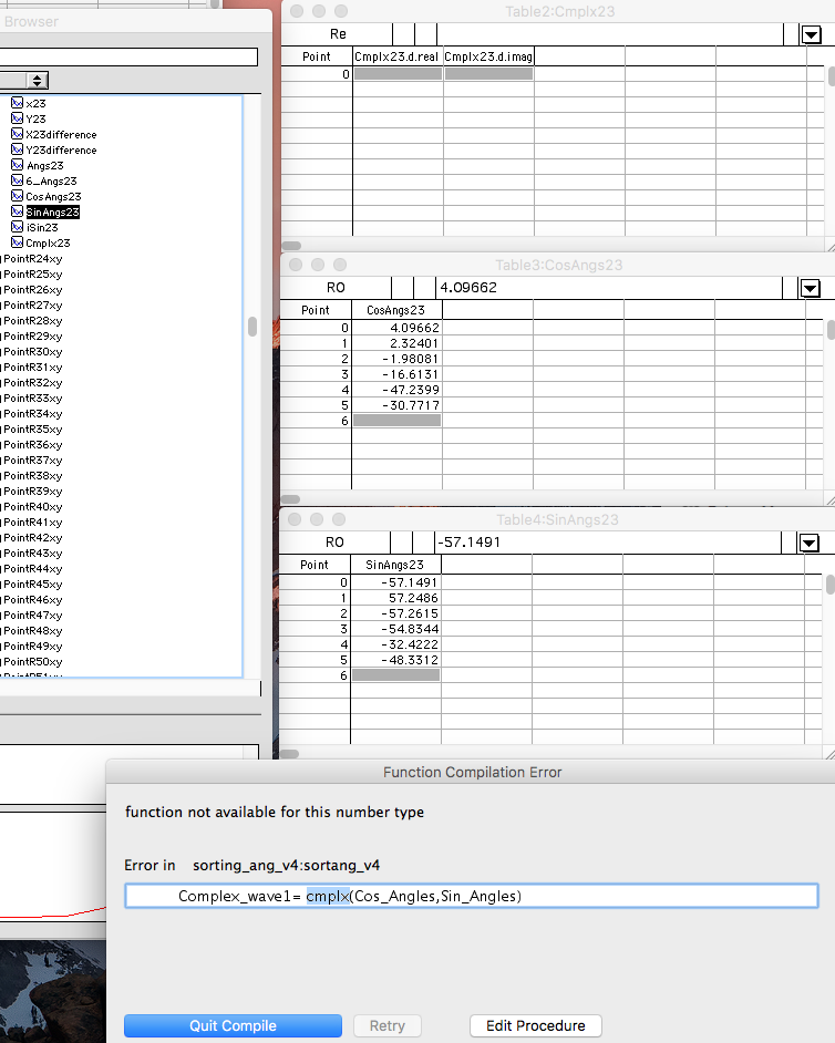

 I get the following error: Function is not available for this number type:
Attached image shows how the waves looks without cmplx(Cos_Angles,Sin_Angles)
