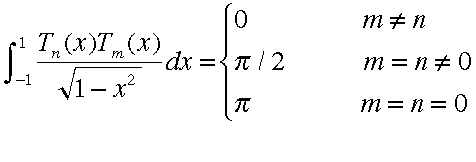

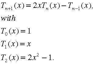

Chebyshev(n,x)
The chebyshev function returns the Chebyshev polynomial of the first kind and of degree n.
The Chebyshev polynomials satisfy the recurrence relation:
The orthogonality of the polynomial is expressed by the integral:

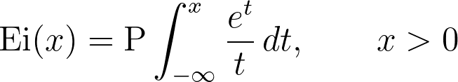

Ei(x)
The ei function returns the value of the exponential integral Ei (x )
where P denotes the principal value of the integral.

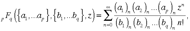

HyperGPFQ(a,b,z)
The hyperGPFQ function returns the generalized hypergeometric function
where the Pochhammer symbol is defined as:

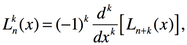

Laguerre
The laguerre function returns the Laguerre polynomial of degree n (positive integer) and argument x. The polynomials satisfy the recurrence relation:
with the initial conditions

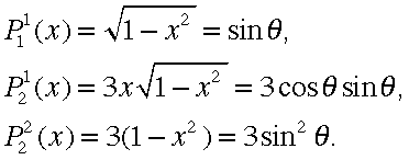

LegendreA
The legendreA function returns the associated Legendre polynomial
where n and m are integers such that 0
The first three polynomials are given by

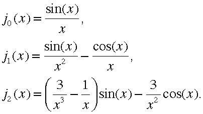

SphericalBessJ
The sphericalBessJ function returns the spherical Bessel function of the first kind and order n.
The first three functions are

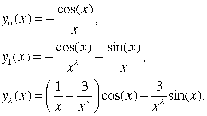

SphericalBessY(n,x)
The sphericalBessY function returns the spherical Bessel function of the second kind and order n.
The first few orders are given by

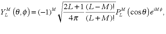

SphericalHarmonics(L,M,t,f)
The sphericalHarmonics function returns the complex-valued spherical harmonics
where
is the associated Legendre function.
