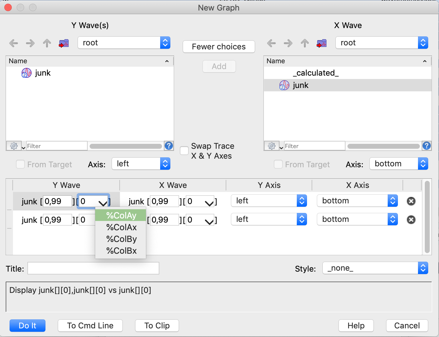

You can enter dimension labels as subranges in the New Graph dialog. If you use the more complex mode (click the More Choices button to display the holding list below the wave lists) you can Add a trace to the holding list, then pop up the menu on the desired dimension and you will get a menu of dimension labels.
John, I should have said that the snippet is meant as a shortcut to the above, I just need fewer characters on the command line ;-)
